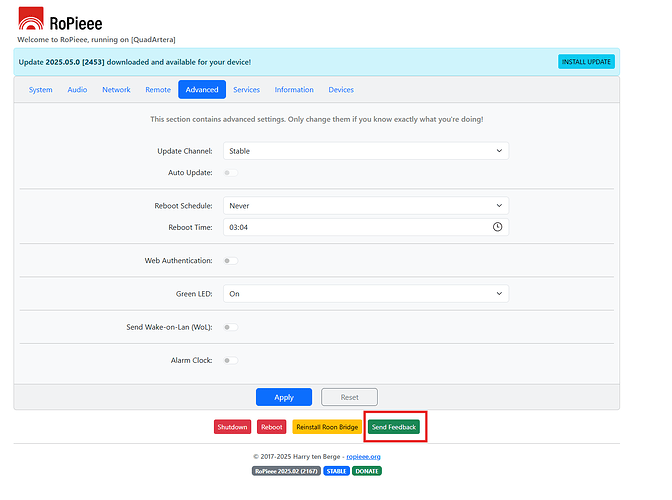

I have “sent feedback” from webui → advanced → send feedback and the identifier is:
b3564945de23d4c2
