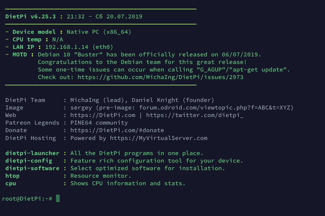

I first used ROCK for Roon Server on my NUC (see my profile), which I refused due to the above reasons and extreme slowness when working with Qobuz and Tidal, then with the success of Ubuntu Server and now switched to DietPi for Native PC
  • this is a great minimalist OS based on the just released Debian 10 with flexible settings for optimizing the OS and CPU performance and the ability to add / remove a large number of third-party programs optimized for the system. For example, it is very easy to install Roon Server, etc.
