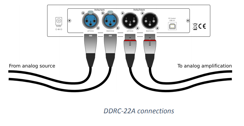

You can use this one and put it between the MSB DAC XLR-out and the Jeff Rowland monoblock amplifiers XLR-in:
Thanks for your suggestion. Yes this would work. But I may be restricted to 96K? I was thinking the SHD Studio would be better as it has no dac ?
Yes, but that is ADC’ing (redigitizing) the MSB’s output to 24/96 digital, applying Dirac filters, then converting it back to analog to send to the amp.
I think the SHD Studio may be better? Any thoughts?
The SHD Studio will resample all incoming streams to 96.
