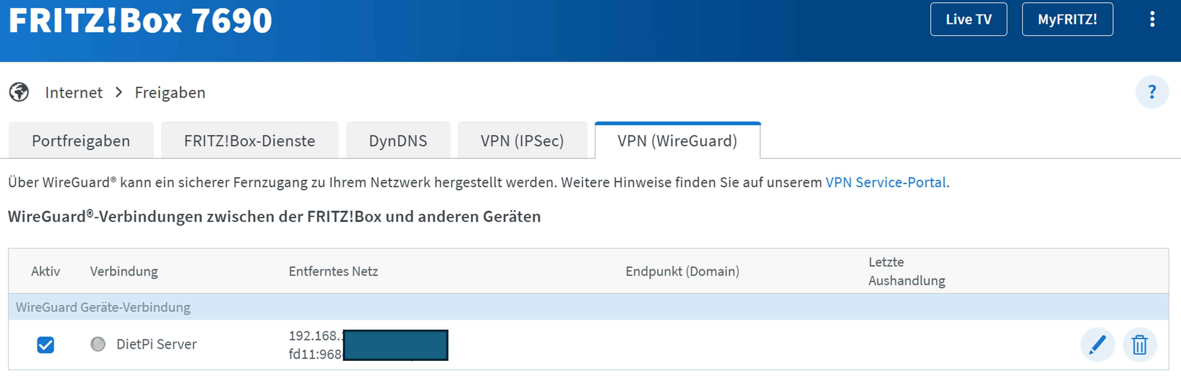

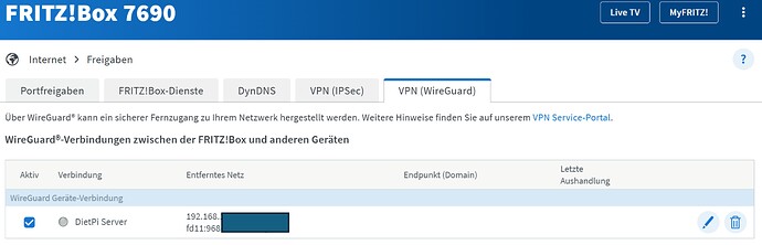

You are using a “unique local” IPv6 address on your FritzBox. This address can only be used locally in your subnet. It is not an official provider assigned IPv6 address. That means your Fritzbox is doing NAT on IPv6 too. This breaks IPv6 globally if you are not doing NAT.
THX, I don’t use NAT and Port Forward is not activated.
This is the solution that I have activated (German):
It works super with ARC.
