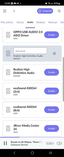

Got it going. Took me a while to find the proper driver to send through the network cuz at first I thought I had to set up a USB cable to use the ASIO like with J River.

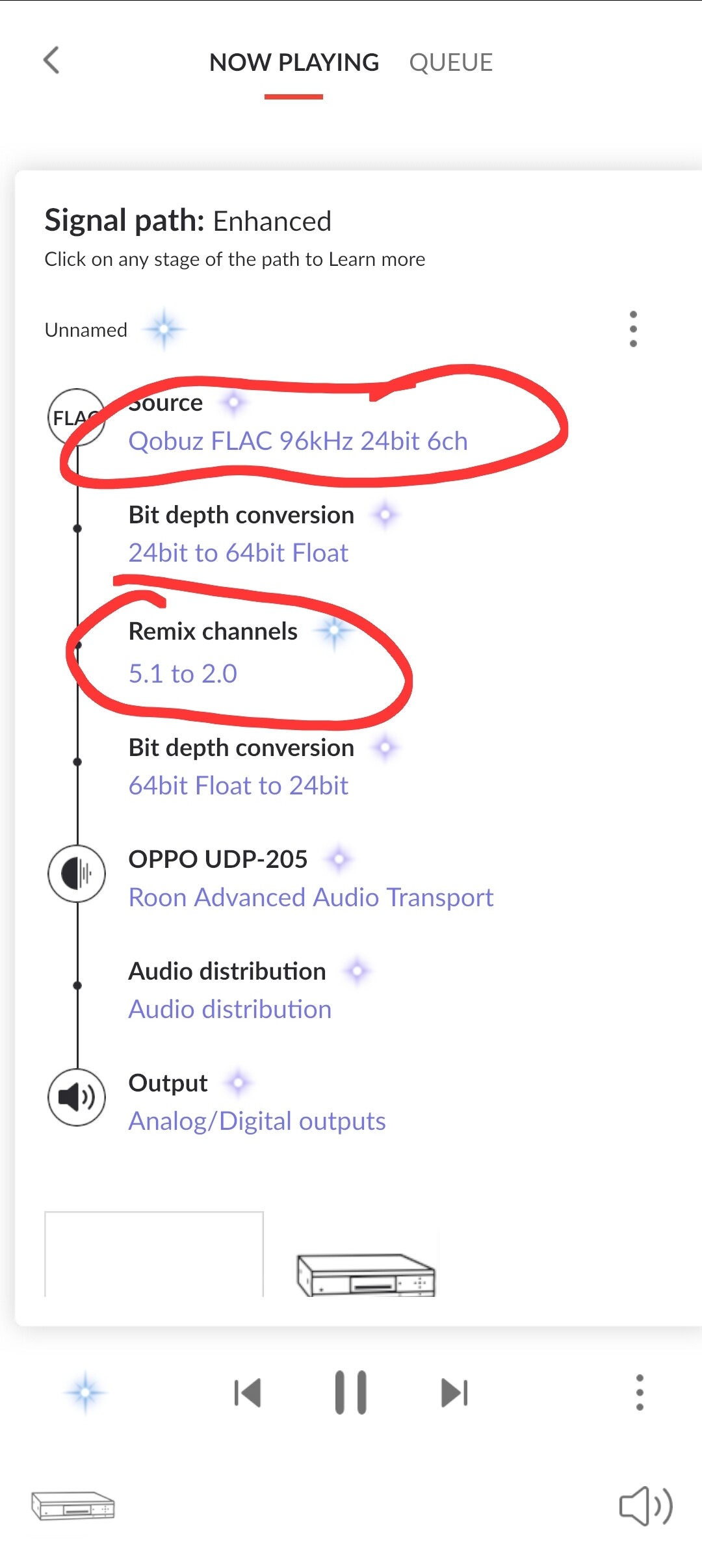

Now I’m just wondering does it have support for multi-channel if the Room hardware can accept it? Seems to always down mix to two channel…

I’ve had my OPPO 205 setup with Roon using 3 zone connections. USB for 2 channel PCM/DSD/MQA, Networked for 2 channel PCM/DSD, and also HDMI for PCM Multi-channel. No DSD over HDMI from Roon.
With USB and Network it’s 2 channel only (no .1 sub channel) but it does use the OPPO internal DACs and 7.1 analog outputs.
With HDMI input, as I recall, the OPPO was simply a preamp/passthrough via HDMI to the AVR/AMP but the HDMI connection did allow for Multi-channel playback.
I love my OPPO 205 for disc playback (4k bluray imax cd sacd) but the 2 channel only no subs interface with Roon was a disappointing for me and my multi-channel system setup.
Please advise if you find something different, and enjoy the music.
Well a little digging answered my Oppo question. Obviously they did this right at the tail end of their existence and they were only able to certify Roon for two channel which is very unfortunate. Add DTS CDs to the list of unplayable formats that you get nasty white noise for:
Due to technical limitations within these Oppo products, the audio interface available to the RAAT firmware is unable to support DSD or multichannel playback.
OPPO is investigating a path forward, but as of now, we don’t know if or when these limitations will be bypassed.

What I found that it CAN’T play to the Oppo Is multi-channel or true DSD… It will do the sacrilegious conversion to PCM. That is an Oppo stipulation they never ironed out before they went belly up.

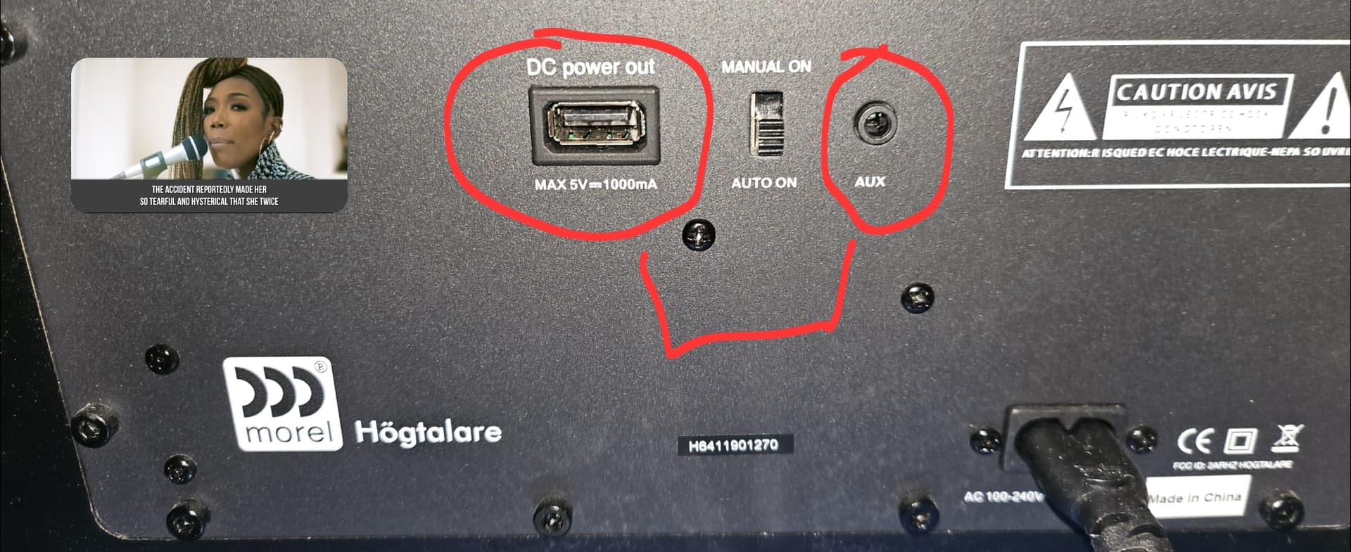

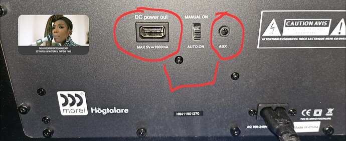

I have another question. I have a Bluetooth speaker in the back that is custom designed to use a Chromecast audio device (with the 3.5 dongle) that for some dumb reason Google discontinued. I hear different reports on if that is Roon capable vs Roon ready.
Bottom line: If I connect to Chromecast audio to that speaker, will Roon see it as an endpoint on the Core machine to play to?
And while we’re at it, just what is the difference between Roon CAPABLE and Roon READY. Last I heard CCA was the former…
Yep. Chromecast is not quite Roon Ready, but it’s darned close. Next best thing to RAAT.
My (great) bluetooth speaker is also made to have a Chromecast audio hooked up to it as you can see by the picture. Now I just have to find one that’s not three times original selling cost :slight_smile:
