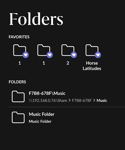

So I am using Roon with an Eversolo DMP-A6. I have an SSD with local files, and when it works, it works seamlessly. Roon server is running on a Mac Studio with latest versions of the software (2.0 build 1445). MacOS is on the latest GA (non beta version) 14.6.1. DMP-A6 is on latest firmware as well - 1.2.98
Every 24 hours or so, the Roon server loses connection to the Eversolo. However, during this period, I can still access the shared drive with other applications. As soon as I reboot the DMP-A6, the files are immediately available in Roon.
