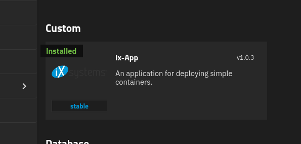

They have a nice little interface for managing docker apps (install, start, stop, logs).

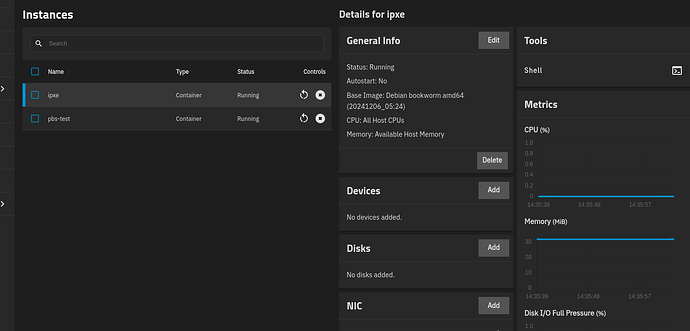

Installed the Fangtooth nightly build.

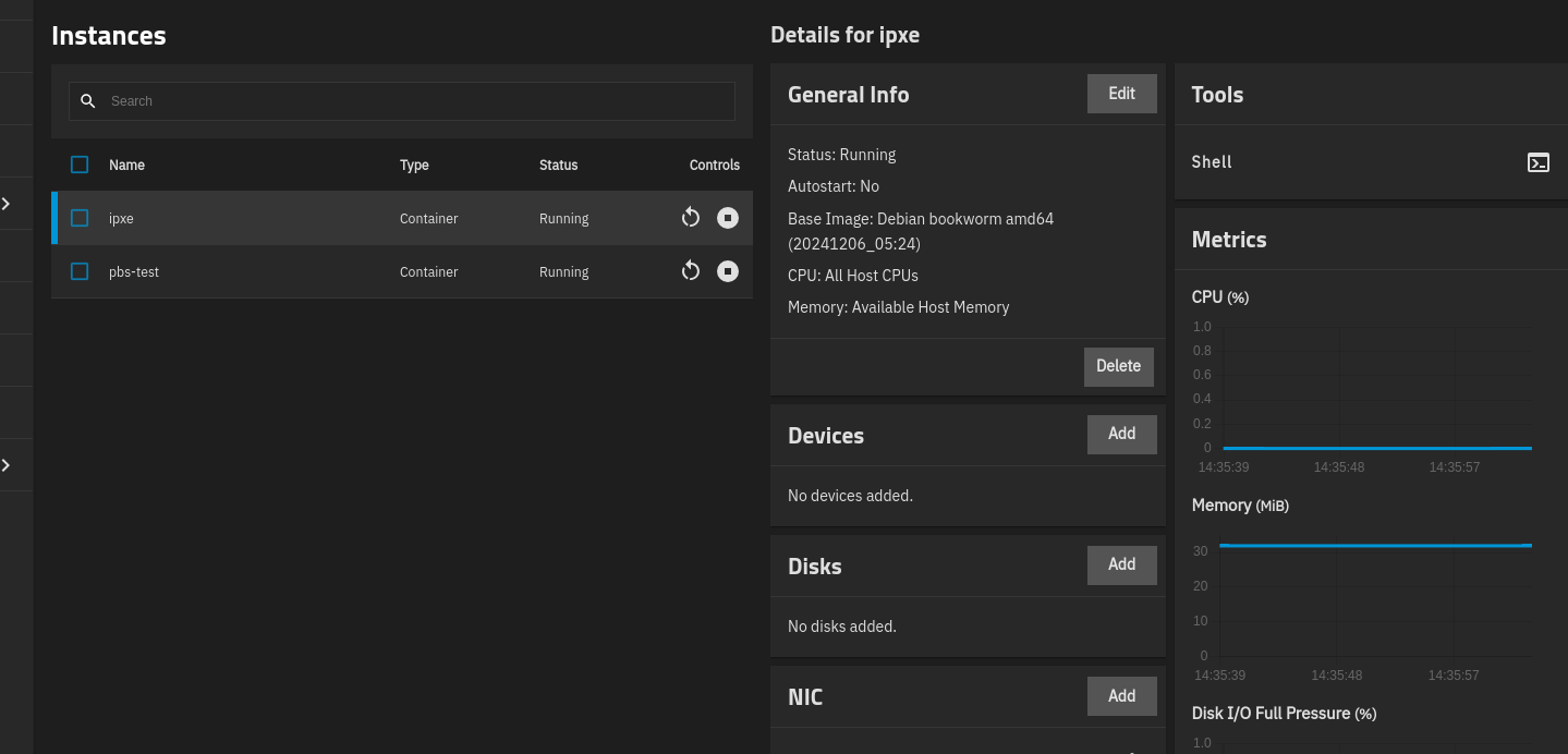

Incus containers are already available, from the command line and from the gui with basic features. This is early development, so there are some caveats (after an upgrade the incus environment is broken, export is your friend). Roon runs no problem.
Incus containers are by default unprivileged (you could make them privileged), whereas jlmkr behave like privileged, so they are much easier to manage.
The jlmkr script still works. So you will have docker, incus and jlmkr, as long as it works.
