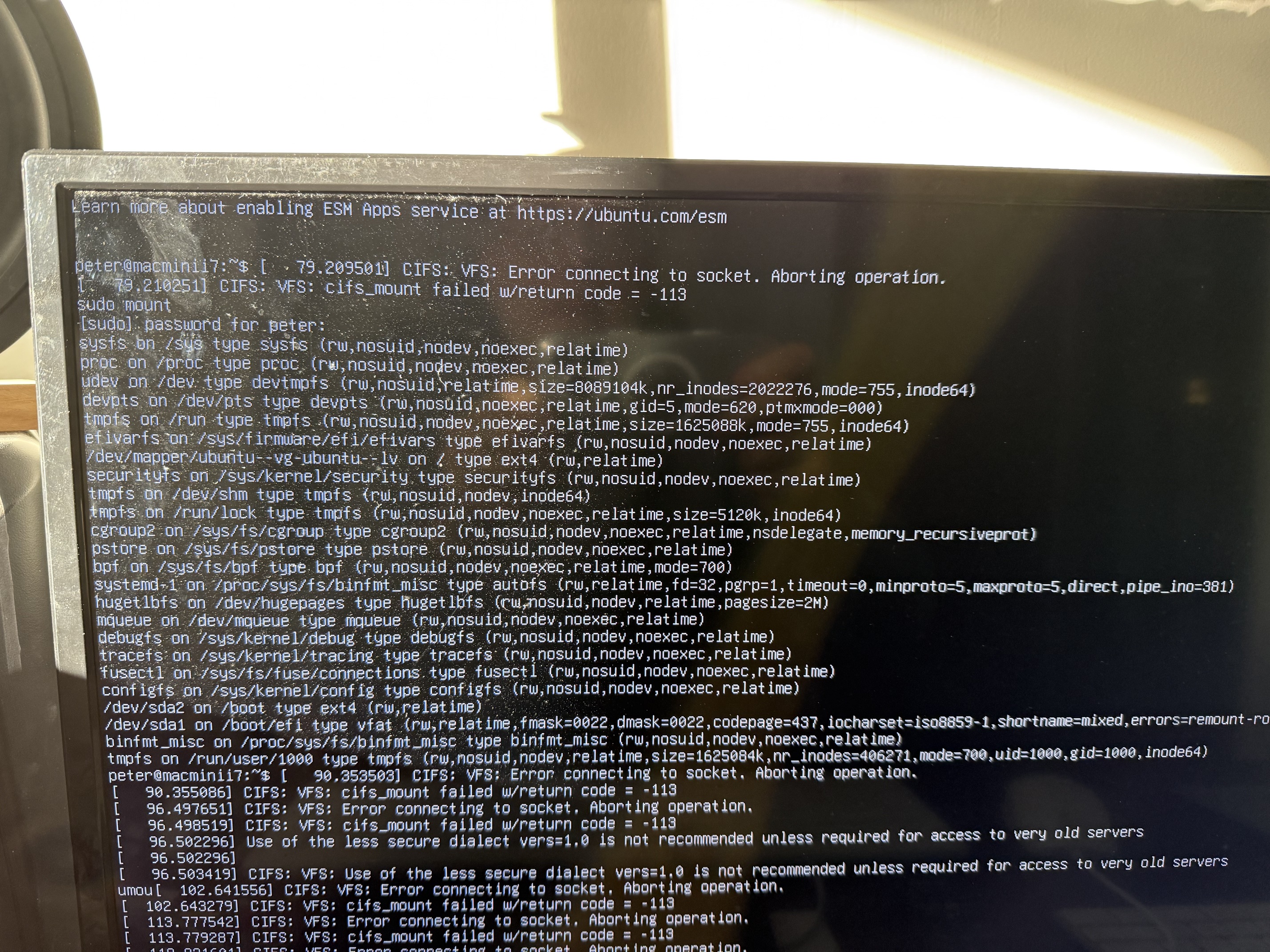

I just converted a MacMini to Ubuntu server and installed Roon.
I’m getting a continuous stream of cifs errors even though Roon appears to function(at least for Qobuz)

Are you running a firewall on the server? Also, have you installed cif-utils?
The never ending stream of cifs errors occurs after boot up is complete. Cifs utils are loaded. So is firewall.
Any way to silence the errors so I can type commands without continual display interruption?

What happens with the messages if you turn off UFW?
Turns out I didn’t have smbclient installed. After installing smbclient am able to link the music server and use “ls” to list its contents.
The cifs messages still persist.
Do I need to delete the existing storage locations from the roon app and re-enter them the get roon to use smbclient instead of old cifs?

The error messages suggest that something is blocking access. This could be network or the Samba server. Therefore, check logs on that machine.
Since it appears to be working, even with errors, I’m thinking it could be related to IPV6, and this is closed (rejected) by the server. Do you have IPV6 enabled in the router?

I don’t have ipv6 turned on.
The cifs errors ceased as soon as roon finished indexing the music library on my other Mac mini. When I did a roon backup the cif errors briefly returned. Other than the cifs errors roon on Linux is a big improvement over macOS.

That’s interesting. Since the errors only occur when indexing or during a backup, I think it could be that the NAS (?) is maxing out briefly, resulting in the connection errors. However, it would appear that retries are successful.
I reinstalled Roon and that eliminated the continuing stream of cif messages. Perhaps the order in which I added the dependencies was to blame. In any case thanks for your help - the issue appears to be resolved now.
