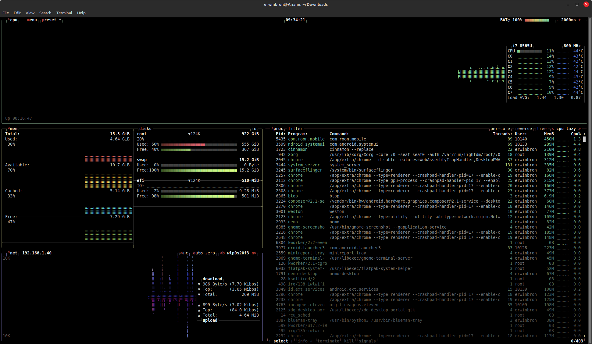

Hey – what command is generating that resource usage output?
Weston. I need to start that in a terminal before I can launch Waydroid.

Or did you mean the second screenshot? That’s btop.
Thanks. Was asking about btop (familiar with top, didn’t know there was a good looking sibling), but interested in trying Waydroid out on a notebook so glad for the insight. I run my core on Linux but use Android/Win for control – this will be a nice option.
I wasn’t aware of btop either. I did know top and htop though. I’ve stumbled on it pretty much by accident.
