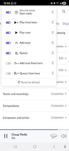

Morning guys just a question does roon radio work on every track or am I just unlucky? I picked a bunch of tracks example coldplay’s latest album and even some of their old material but I just do not get roon radio option on a track. Am I doing something wrong? Thanks

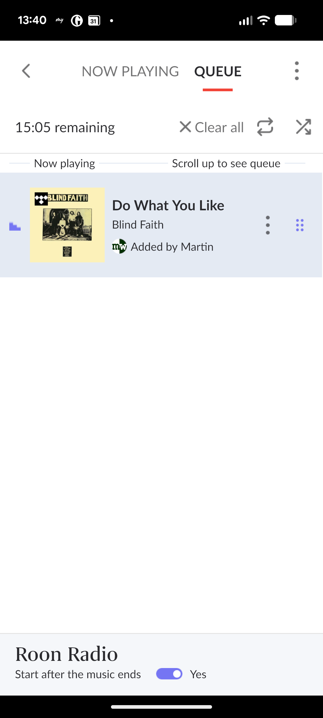

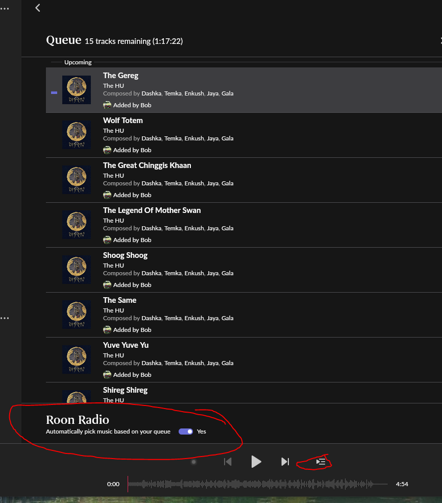

If you add thones you selected to your queue and then toggle the “start radio” in the queue. Roon will then after what you added has played it will start the radio based on what is in your queue. You might want to clear the queue before adding tracks so that it only does the radio on what you just added.

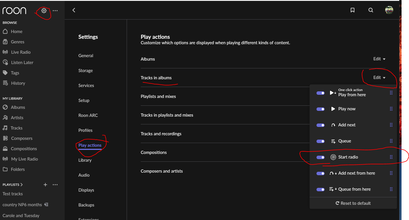

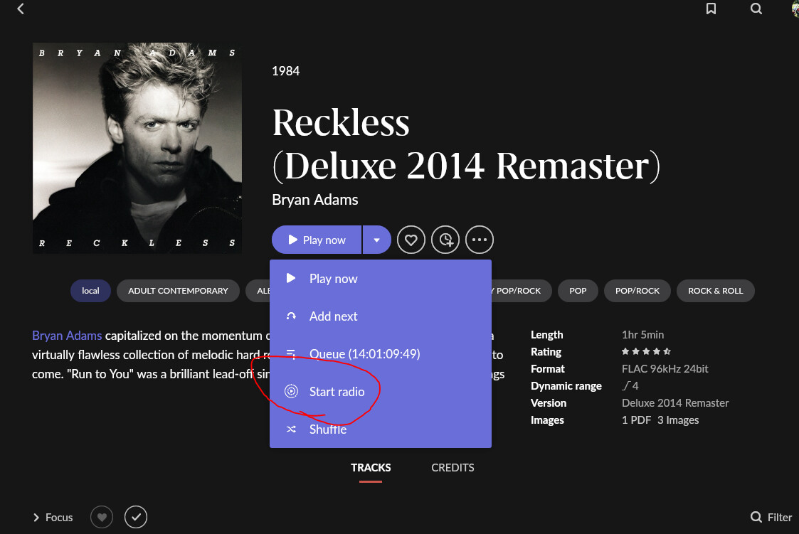

Edit2: You can start the radio from the album page (make sure “start radio” is enabled in settings paly actions for album, like I describe below for tracks).

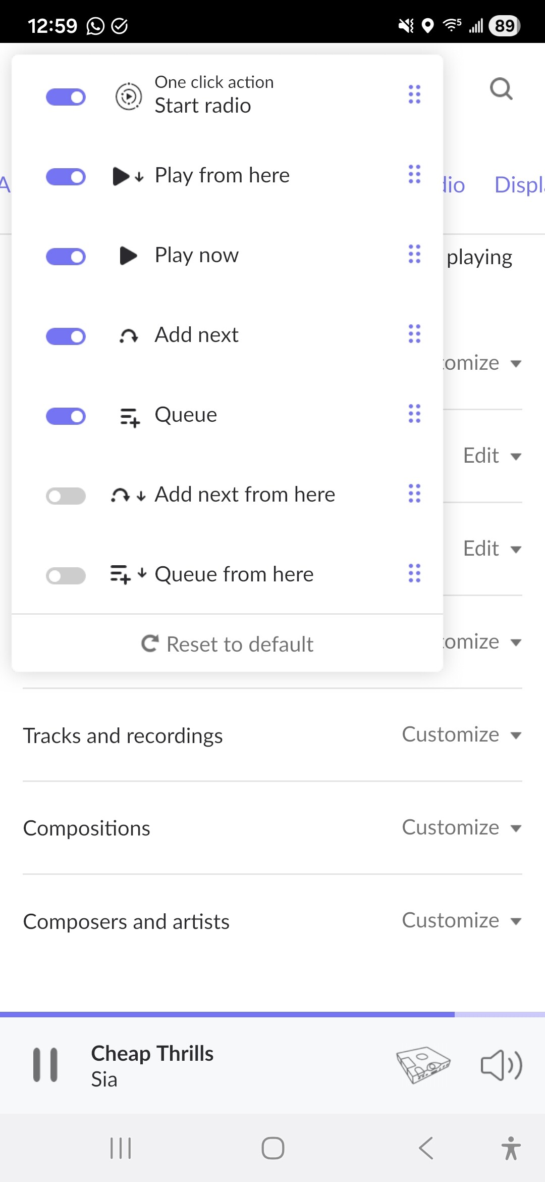

Check “settings/play actions” under the Tracks section click edit and make sure that “start radio” is toggled to be shown?
Appreciate the help I’m not sure if I’m doing anything wrong because it looks like it’s correct

So I would first, clear the queue, and then either “start radio” from the main album page, or add all the tracks you want to the empty queue and then toggle the radio “on” in the queue so that it starts when the tracks in the queue are finished.
Ok thanks will try that
Actually you’re right if I go to the album from the song that’s playing I then get the start radio option. What’s a bit strange is I can’t seem to know go to radio from the track that’s actually being played

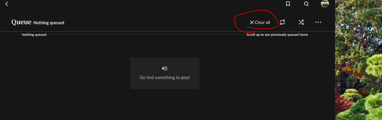

how do I clear the tracks I don’t see any option for that ?
The easiest approach in this scenario is to enable Radio in the queue. When the last track finishes, Radio will start, based on that track.

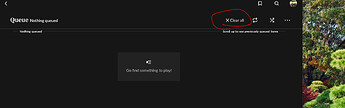

In the queue click “clear upcoming” if there are any upcoming tracks:
Then click “clear all” (which will clear all previous tracks):
Then add you tracks and toggle on the radio…
