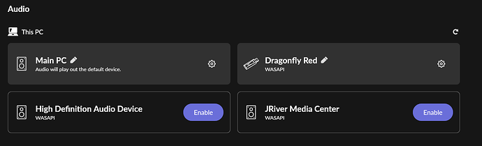

The Dragonfly will need an app to go through it won’t show as a network device direct this is my Win10 with Dragonfly inserted
My Roon Server is a NUC/ROCK ,when I plug my Dragonfly into my WINDOWS PC I see Settings>Audio. If I plug to the NUC (I can’t just do this) I should see Dragonfly in the Roon Ready section I think.
Have you enabled the Dragonfly in Settings

I can’t enable the Dragonfly in Settings because the DAC is not shown at all.
