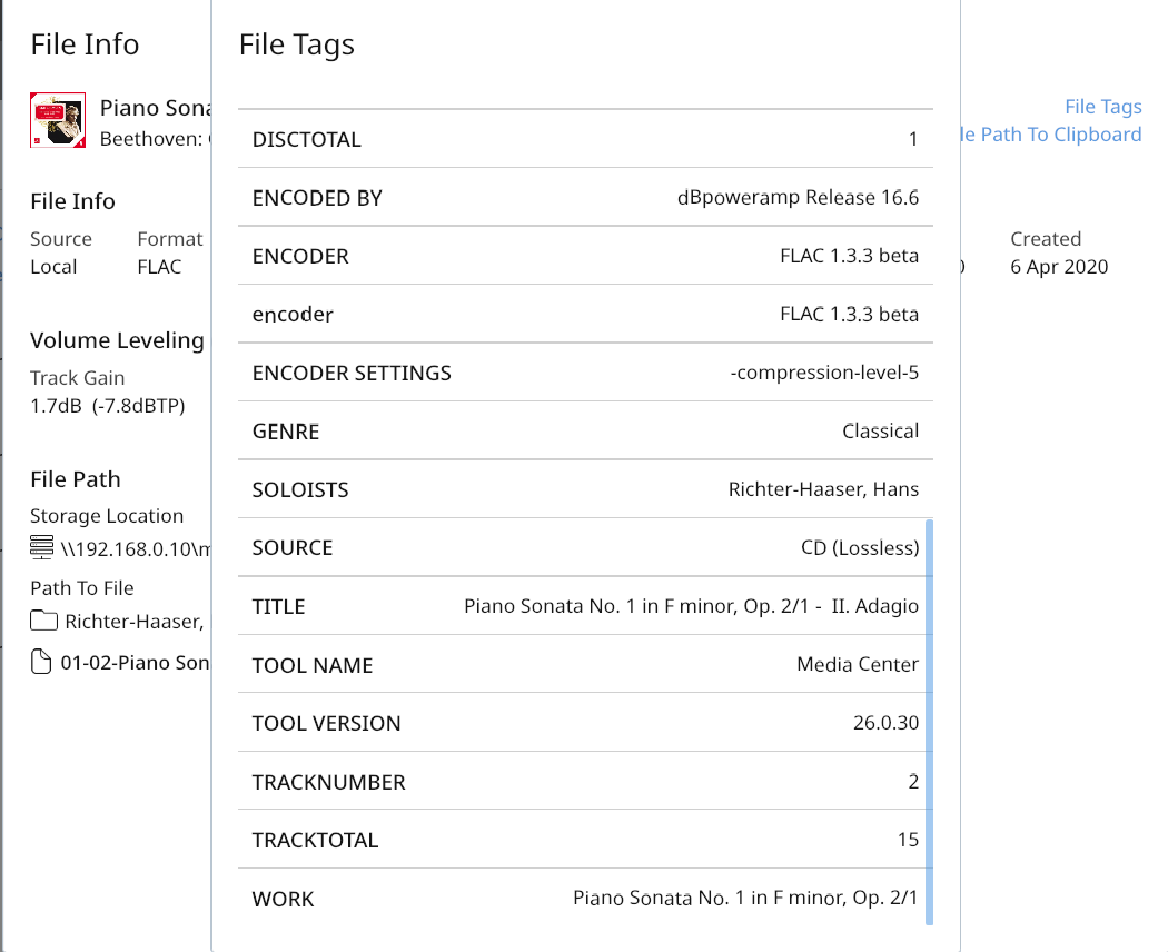

Next I took up the suggestion to add work tags to the first sonata. This is the result with preferring the file tags
No work grouping
Next I added a custom Tag “Part” in jRiver and set the movement names to this tag “Part”.
Rescanned the album in Roon. No Tag part shown in the file info.

As can be seen from the example in the documentation linked above, you need WORK and PART file tags in every track. Work is a string that references/names the Work (Composition) the track belongs to and Part is a string that provides a name for the Part (Track) in the Work. The track’s TITLE file tag could theoretically be omitted (not recommended) for multi-part compositions as it’s content isn’t shown by Roon (on default settings). If only a WORK or only a PART tag is present in a file then Roon will use it’s own metadata.
As I don’t know JRiver I can’t provide any help as to how to create a working PART tag.
Thanks @BlackJack
Using MP3Tag I got it to work
The PART Tag is now seen by Roon and the works are identified correctly.

You need to find out what is wrong in your case.
In my case the diagnosis went as follows:
  • I added the WORK and PART Tags with jRiver and verified I could see them in jRiver
  • re-read the album in Roon and found out I could NOT see the Tags in Roon (three dots in track, file info, file tags)
  • used mp3tag to add the WORK and PART tags and found Roon could now see the tags
  • Switched to prefer file and the work structure was now displayed correctly
Can roon see the tags in your case? I suspect not
