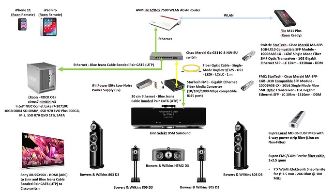

This is my current setup:
Torben
And you have the cirrus on the same rack with Linn? HQP it will not work with RAAT. HQP uses NAA for network, so you have to check if the Linn has NAA or go USB

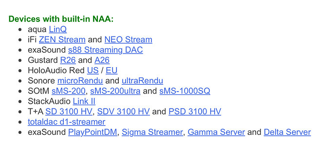

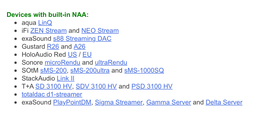

Linn doesn’t have NAA therefore you have two chances:
connect the Cirrus to Linn with usb
get a NAA endpoint to be connected to Linn, the NAA endpoint must be connected on the same lan.
NAA capable endpoints could be the ones referenced in the screenshot
