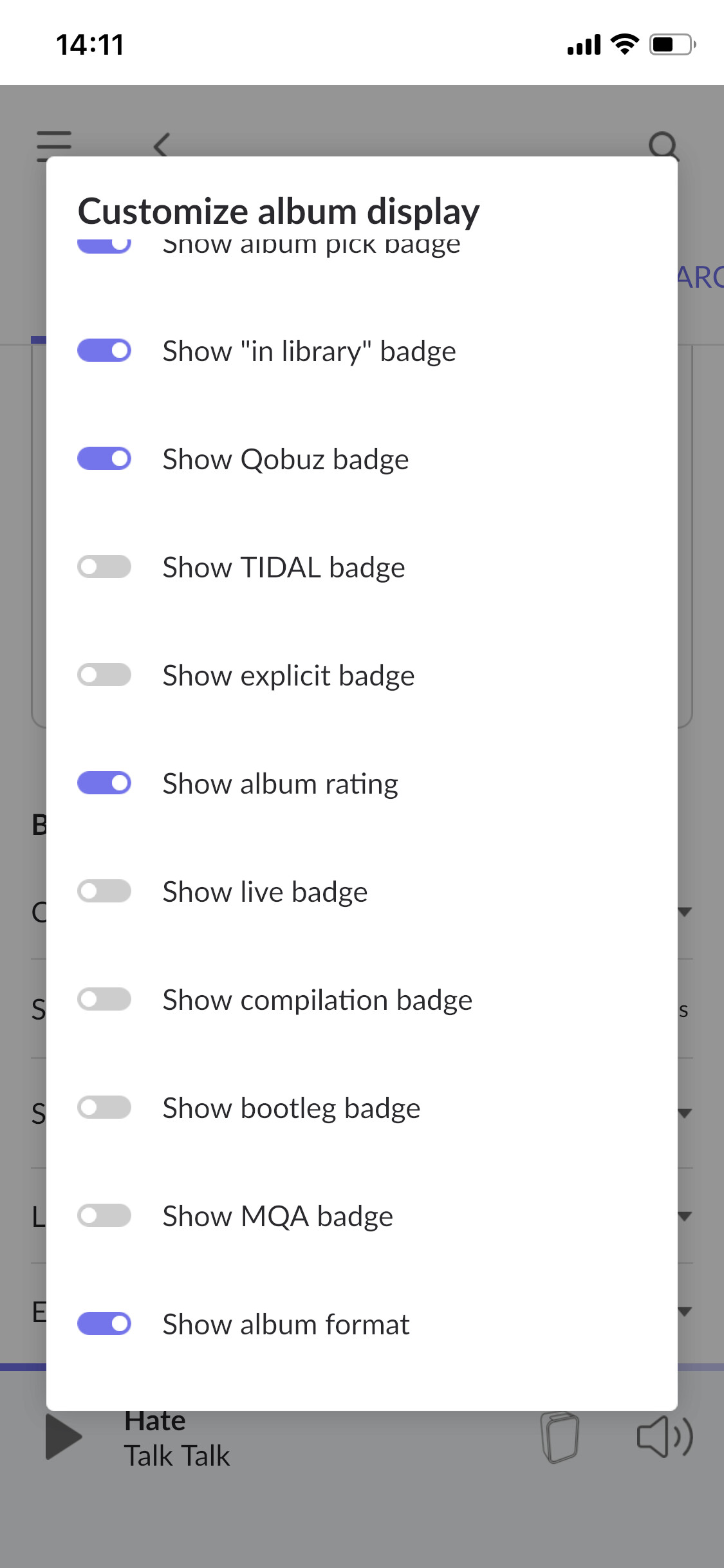

  1. For the main ROON software is there any way to show high-res albums and their bit rate for QOBUZ on the main page? Seems like a really blatant oversight… there’s got to be a way to see that important distinction other than physically looking at the audio trace?

  1. Go to Roon Settings > General and configure the information you want to see for each album in the overview on Library > My Albums. The resolution is one of the options

Go to Settings > General, and select Customize album display.
