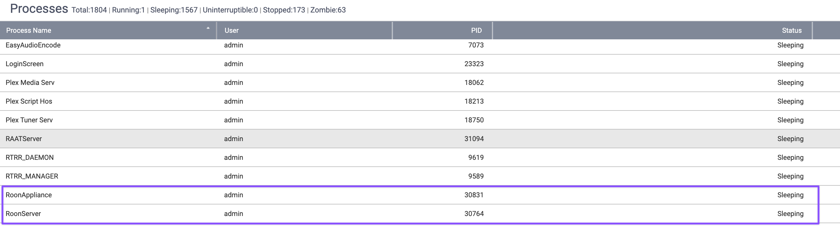

Here’s a screenshot of the QNAP event log. I’m no expert but it seems it’s installed just fine.
The second screenshot is from the resource monitor and the two Roon services look like sleeping.
In the Roon Server app, the service keeps showing it as stopped, and the database location I select keeps showing as blank.
