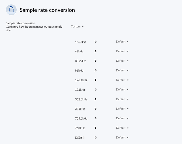

As another step in troubleshooting, try upsampling everything via MUSE to 96hz first and try to drop out on
  • Your MacOS Zone
  • Your RPI 2 Zone
  • A grouped Zone with three or more endpoints
After that, set everything to 44hz and try the same tests above 1-3 on the same Zones. We’ll monitor for your results - thank you! 👍
Hello @benjamin
Did the tests as directed.
When zones were alone no problem occurred (which is normal, it never skips on isolated zones, only on groups).
On 96hkz it took a LONG while for the skip to happen. Many hours. It happened eventually, and only when I used a zone with more than 4 endpoints grouped together (all set to 96hz fixed) - I am sure if I added convolution equalizer to any of them, for example, the skips would happen much earlier
On 44hz the behavior was more or less the same. Needed a zone with more endpoints to reproduce the skips (3 or more), but it seemed to happen faster than on 96hz.
tests were run during the last 36h approximately.

Turned off convolution equalizer on zone 2 (keeping only 96 khz upsampling for all zones): played fine
Added zone 3 (8 - 7 - 6 - 2 - 3) - all at 96khz - problem appeared at 10h48 (it is much less frequent when DSP is “lighter”)
