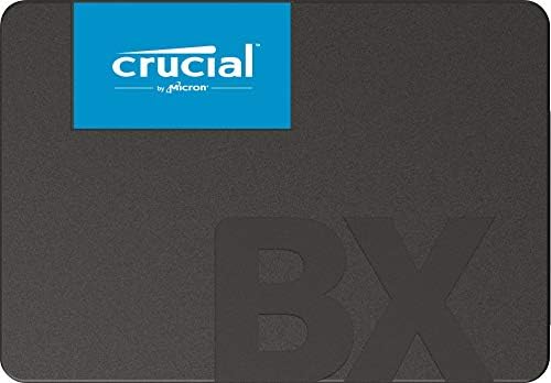

Any 2.5” SSD would do if you prefer to fit in one of the bays and it doesn’t need to be larger than 120 Gb, larger if you want but no need. You could also fit this in a small external USB 3 enclosure and plug it into the rear of the QNAP, it will still work using this method and leave all your bays available.
Enclosure
Things will be snappier using the M.2 or installing the SSD internally in one of the bays but this gives you some options. If you are happy to use one of the bays you can go for a larger SSD, create a Storage Pool and a 120 Gb volume named “RoonServer” and use the rest of the SSD as storage for other files. Hope this helps you out.

Although I have the Crucial M.2 drive on order, I’ve went belt and braces and ordered up the Crucial BX500 Internal SSD that you suggested as well, although went for 250GB. Reason being that I’m sure I read somebody posting on a thread on here that 128GB was a bit tight - anyway better to have more than not enough. Between the two of them I’m sure I’ll manage to fit at least one of them lol. The other one can get returned to Amazon :slight_smile:
I’m not to worried about using one of the bays for SSD if that’s what ends up happening, I doubt very much if I’ll even use 2 of the remaining 3 bays as I’ve only got about 1TB of music and most of my listening is on Qobuz or Tidal anyway.

Went with SSD in bay option. Thanks to @Scotav with all his help and tips.
