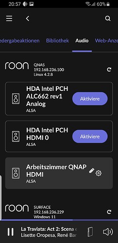

Sometimes I’m using the HDMI out of my QNAP connected to an AVP and play then multichannel sources.

Do you’ve installed the alsa package?

I don’t have the alsa package installed. What does that do and how can i get it? Its not a normal QNAP app.
