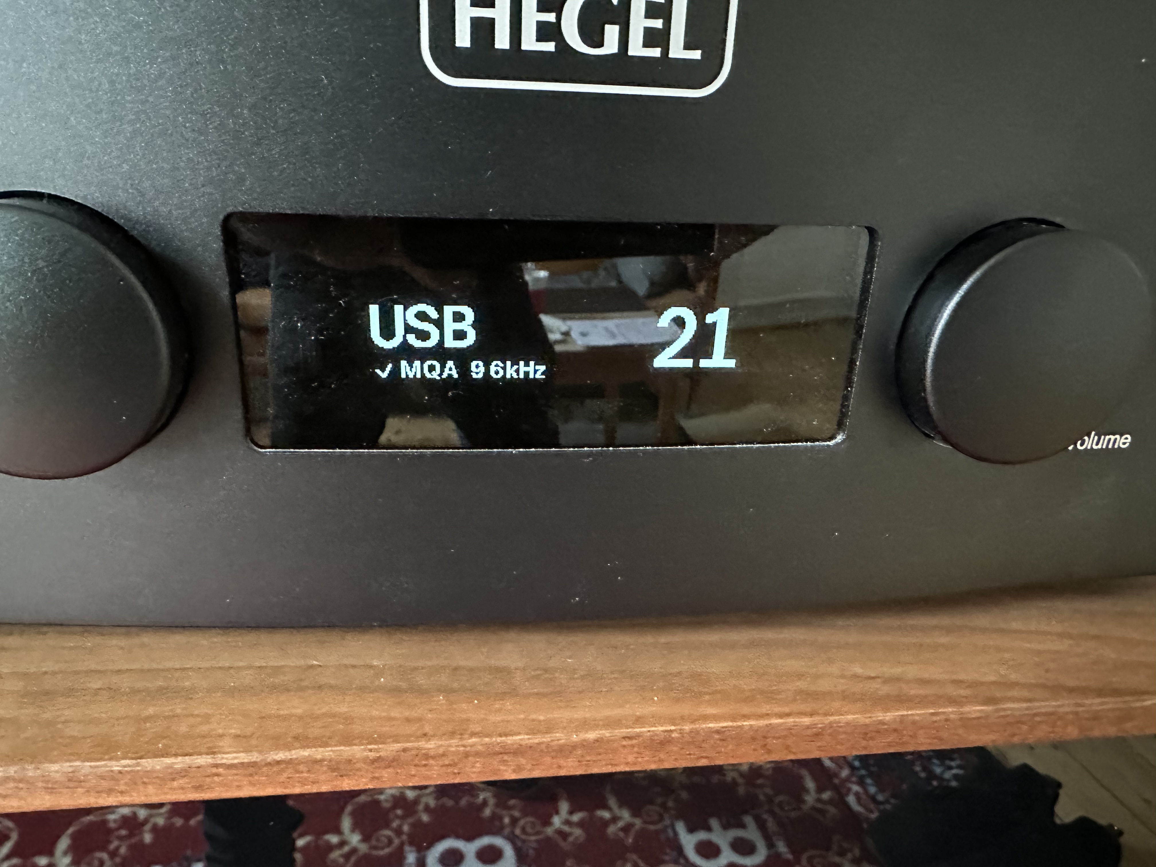

First using Roon on the computer over usb:
Playing 48KHz MQA works. Playing 352.8 MQA works. Playing 48KHz plain works. Playing 96 KHz works
Here is example pictures
Then using tidal(cannot check what it will output in tidal). With the right settings using the same Steely Dan album in 96KHz MQA( in a 48KHz base file ) works and I get MQA 96 on the Hegel display
Here are some examples
So definitely something something wrong when using the network input with base sample rates other than 44.1
So this narrows the issue to the network / RAAT implementation section. I’m sure Hegel will be able to sort it out for you with this information.
