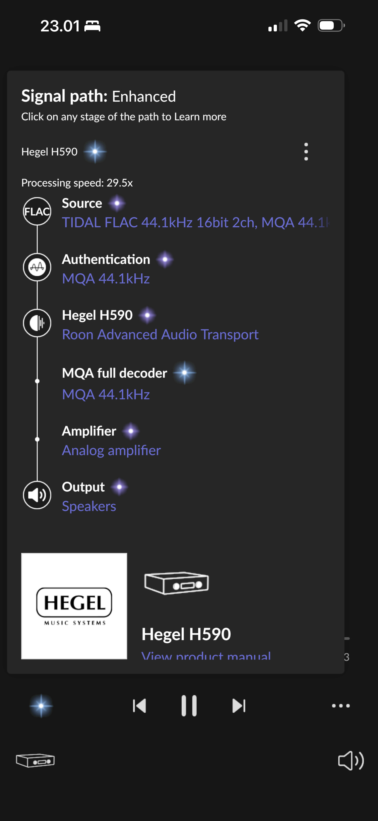

According to the signal path, your core is sending a 48 kHz PCM stream to the amp with MQA signalling. It appears that Roon is not set to use the core decoder.

I trust Roon’s signal path, and everything looks correct upto the Hegel, after that I agree it looks very odd and this is now inside the Hegel. After the Hegel, Roon is simply displaying what the Hegel is reporting back.

The behaviour is the same after power cycling. It is also totally reproducible playing track which unfolds to MQA 44.1 is decided as MQA by the Hegel as can also be seen in the signal pat
unfolding to MQA 44.1 works and I see the “mqa full decoder” after the Hegel step in the signal path(as shown earlier screenshot) MQA 48K or MQA 96K doesn’t work (and I don’t see the “mqa full decoder” engaged and the Hegel will display 44.1K which seems incorrect

This H590 would play anything up to 24bit/192khz via network, MQA will be decoded automatically when present in the stream, that is a mandatory feature which can’t be changed or bypassed. What you see in the display would be the signal received by the amp, so I this is likely a problem with the Roon setup.
A normal signal path and corresponding display shown below:
