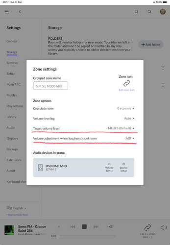

Check volume leveling parameters in Zone settings by clicking speaker icon bottom right then cog wheel in the pop up.
AFAIK radio stations don’t transmit volume leveling info, so the rub is in the difference between the two highlighted settings …
Edit:
Don’t worry, you’re actually not pushing your amp harder by turning up the volume to compensate for a weaker input signal.

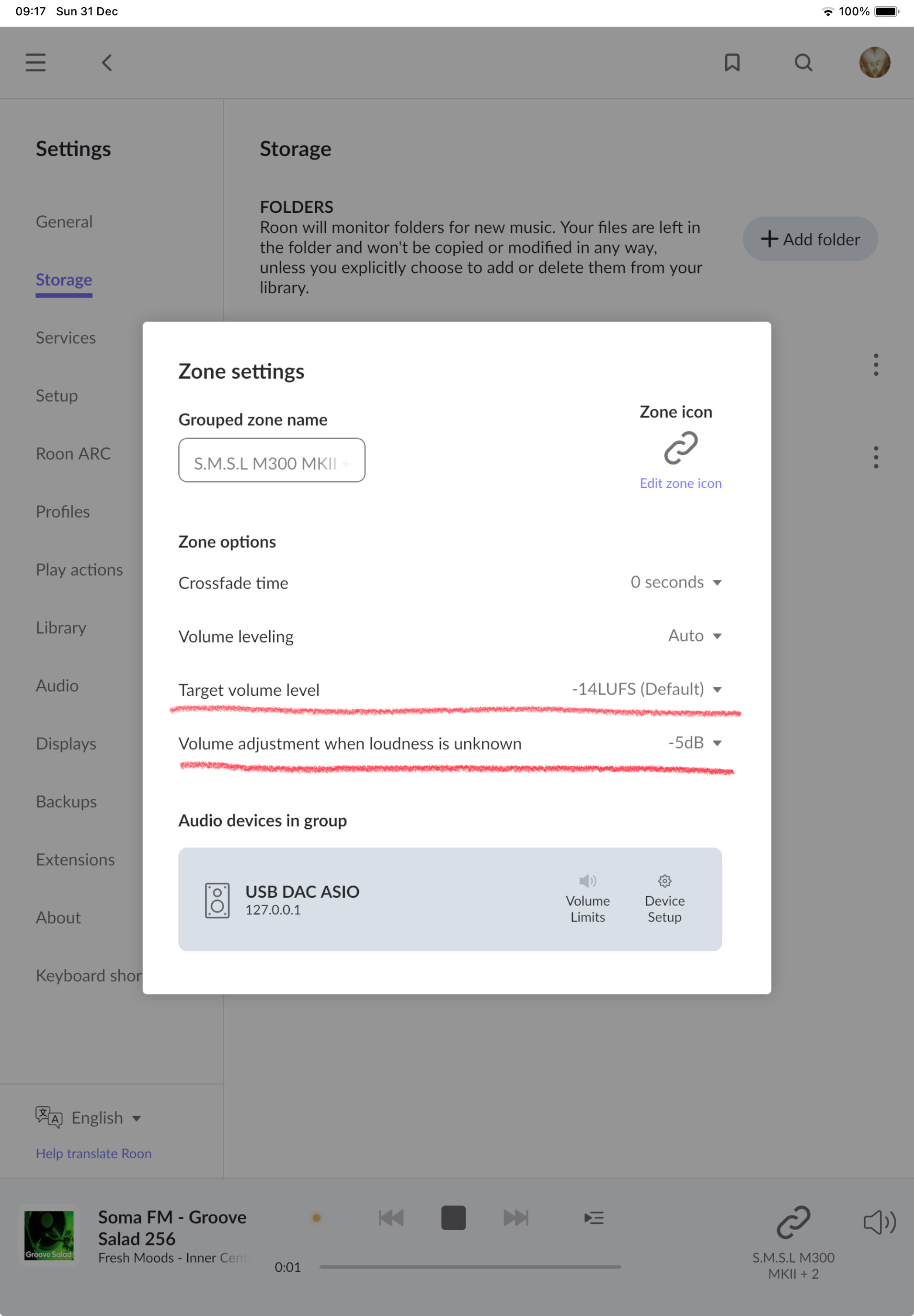

These too are the settings in my roon. Should I change them?
Do a test, turn leveling off and listen, set unknown to the same value as the target and listen, just play with the values until you’re satisfied!
