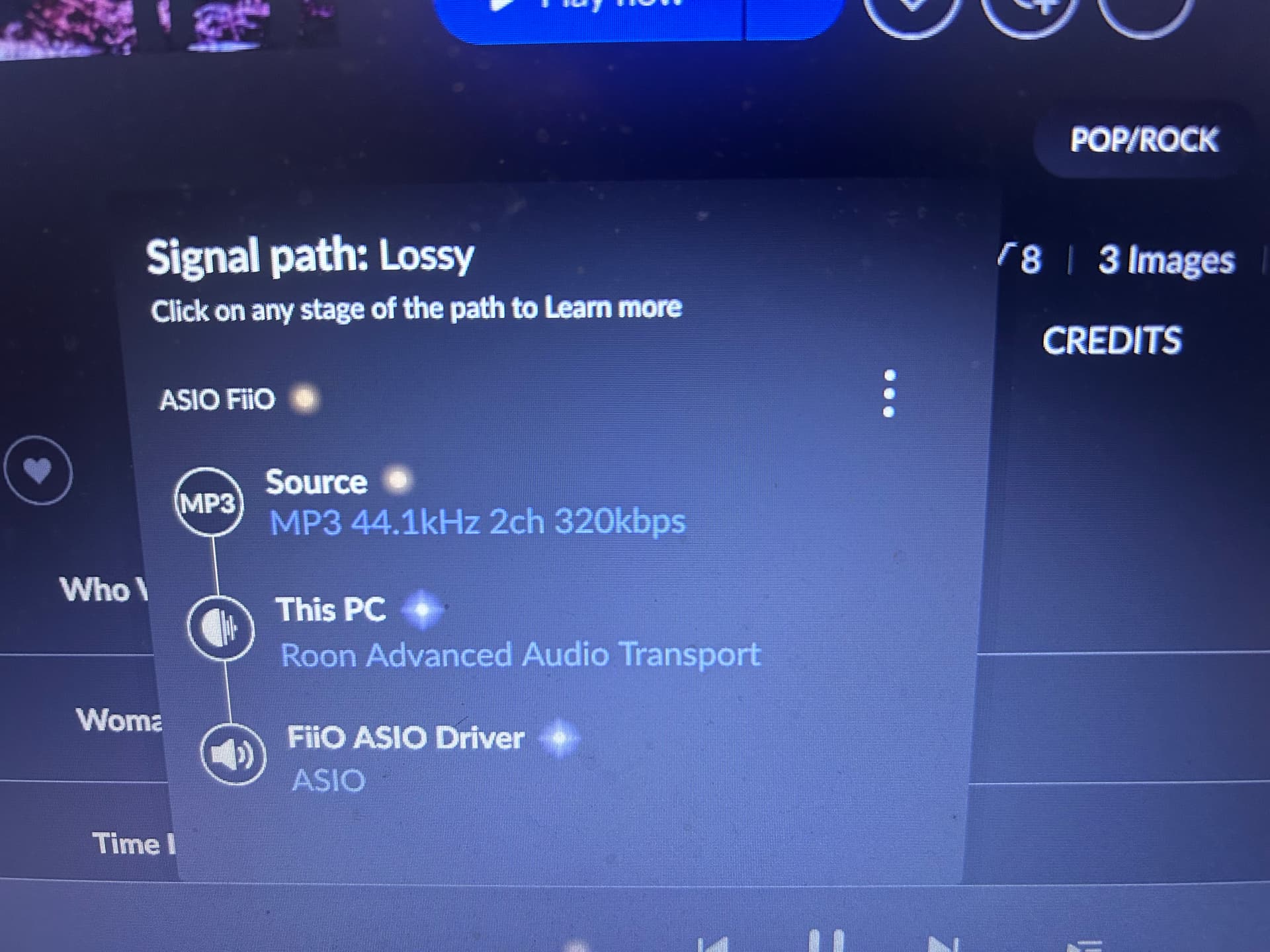

Can you post a screenshot of Roon’s signal path, this will help to see if there is anything else happening to the digital signal.
I suspect this will confirm that Roon is streaming a bit perfect signal to the DAC.
So after that consider what the Tidal app might be doing to the signal.
I think you are on to something … on this album the dot is glowing yellow. Where it glows purple the sound is allright… maybe because that album is 320mbps source I don’t know . If you know the trick I’d be very grateful (but most of the songs glow violet - which is good )
The Signal path shows that you are playing a local file. In that case, any volume/level/dynamic range differences between the local file and a Tidal stream have nothing to do with Roon.
AJ
I am such a noob. I have a million files (downloaded millennia ago), I forgot that Roon shows them first :frowning: problem solved thank you
You are also playing a 320kbps file. A compressed MP3 :slight_smile:
