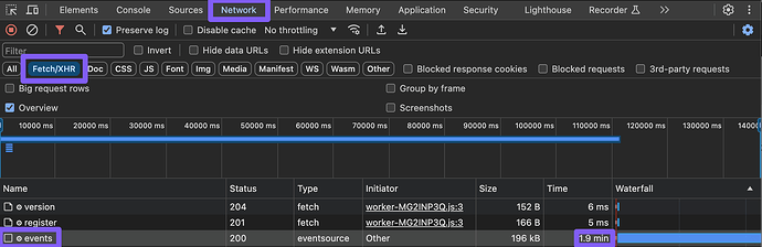

Hi @Norbert_Preining
Here is a screenshot of the web inspector in a chromium based browser
If you open the dev tools, go to the network tab and filter Fetch/xhr requests and then refresh the app, you should see these 3 requests.
The third one is the event stream, and should ideally stay open as long as the app is running.
Hi @nihil
yes, so it does. The eventsource connection did remain open for several actions and starting streams.
Hi @Norbert_Preining, everything seems fine…
Thanks for checking, we won’t find what was the root cause of your issue, simply enjoy that everything works nicely now.
