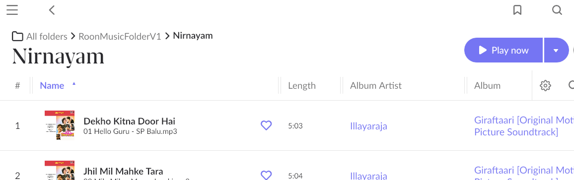

It seems I need to use Home assistant media player with service ‘play media’ and select content id. What should be content id for the listed folder shown in the screen shot?
Also, media player is just HA generic player and there is nothing that says content id is from Roon. How does it find it is Roon path? Appreciate it.
