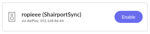

when you tried switching RoPieee to AirPlay 2 mode, did you also go into Roon Settings > Audio and enable RoPieee (ShairportSync) via AirPlay in the “Other network devices” section?

if this option isn’t showing in Roon settings, or if it’s already enabled, then agree with @Simon_Arnold3 there might be something unique to your setup, in which case sending feedback/logs might help
Yes, I had done that. Anyway, I reconfigured and tried again. This time (in my NY system - ubiquiti amplifi router) and rebooted everything. Roon sees the endpoint, but it won’t play anything. I switch back forcing to version 1 - everything works. I suppose no harm done staying on 1, but I think the 2 compatibility is buggy.
