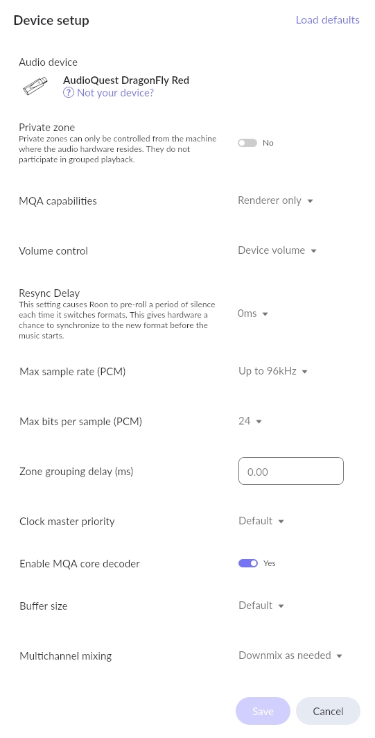

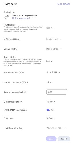

Can you show a picture of the Roon settings (device settings)?
Sure - please see below. Apologies for any rookie errors in my setup(!) - really appreciate your expertise :+1:
Hmm… ok. Hardware volume control.
