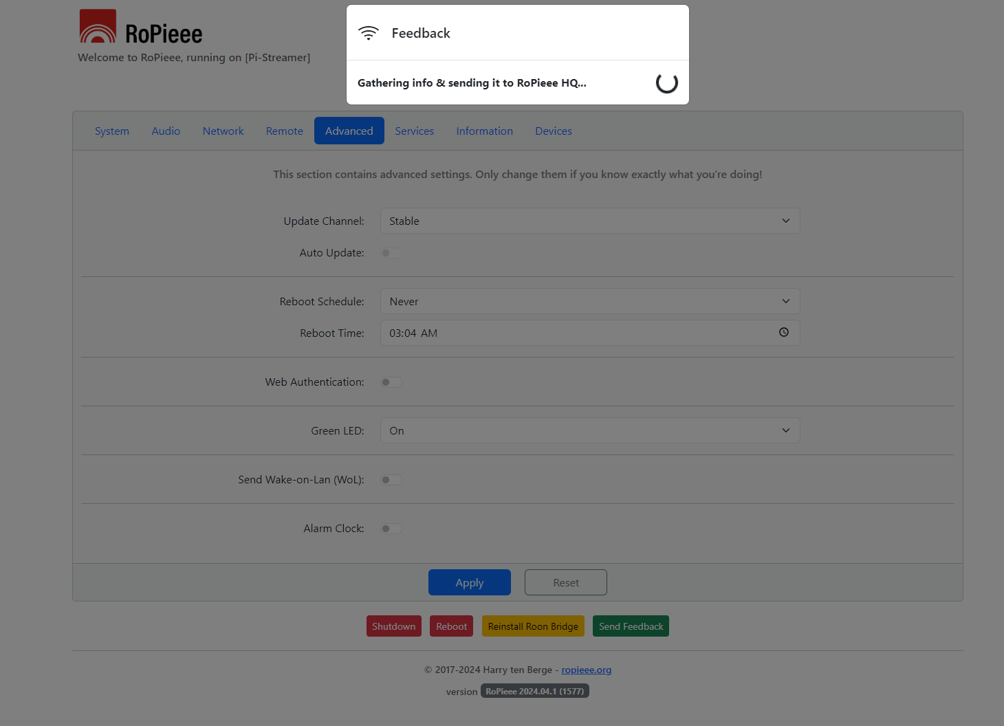

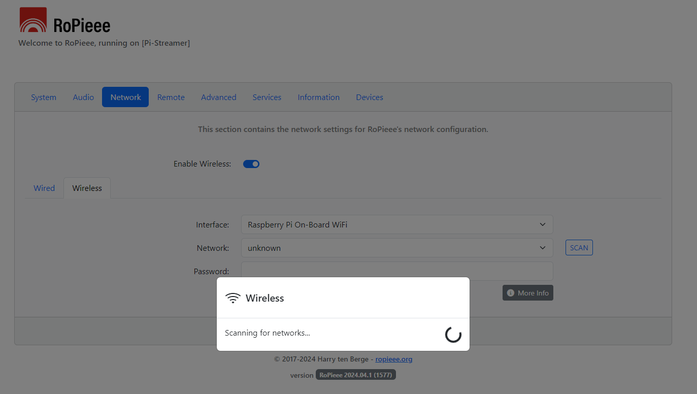

I just put together a RPi4 Model B, 4gb RAM with a 32g b SD card with a HifiBerry Digi2 Pro HAT. Initial set up seemed to work and Roon sees it as an endpoint, but I cannot get it to detect wifi. It endlessly scans.
It also doesn’t seem to want to send feedback either, and I’m stuck with this message.
I’ve flashed it 3 times, once with different SD card, and nothing changes. Rebooted from the web interface and by disconnecting power without success. I’m sure I missed something, but could anyone point me in the right direction? Thanks!

I’m looking at it more closely, and I see there’s a bug in the webinterface :frowning:
I’m going to fix this asap, so if you can live this for for a day or so then this will be fixed.
Thanks (and sorry :wink: )

Hi @Nick_Lukens
I’ll prepare a hotfix for you. This will be ready in a few hours that fixes your issue.
I’ll let you know when it’s available and what you need to do.

Hi @Nick_Lukens
I’ve released a hot fix. If you reboot your unit it will automatically repair and you will be able to scan wifi (and send me feedback).
This should fix your issue, please let me know how it goes.

@spockfish The hot fix worked! I’m up and streaming on wifi without issue. Thanks for the quick turn around on this, donation incoming. Thanks to everyone here for troublshooting!
