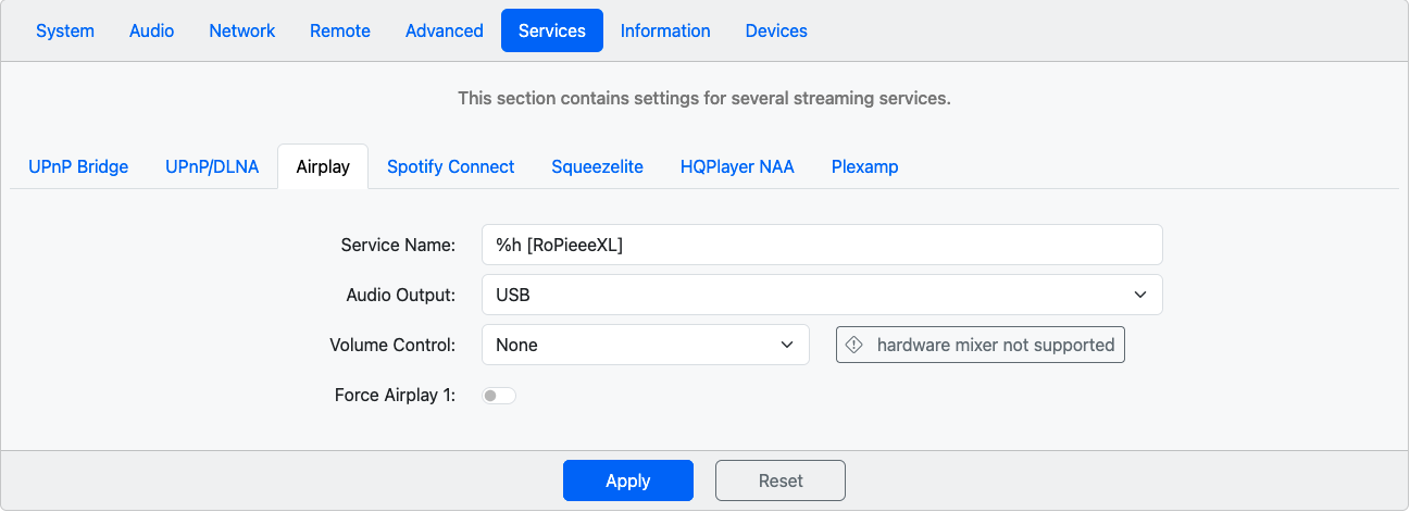

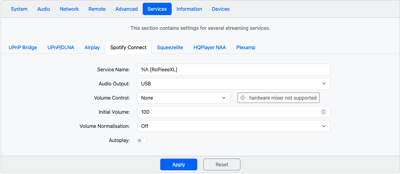

I use Ropieee with a Holo Red feeding into a T+A DAC200, with HQplayer running on a Mac Mini. Devices are on a Netgear Orbi network with ethernet between the Holo Red, the main Orbi router and QNAP NAS (which is running Roon). HQplayer and Roon work perfectly, however when I try to use Spotify or Airplay, they show as working on the end device, however nothing is fed to the DAC. I have checked all the settings and they look correct. Any idea what is going on?

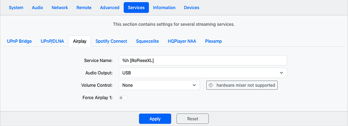

Post a screenshot of the Spotify and Airplay setup screens on the Services page from Ropieee’s webUI
Ok, looks good there.
My thoughts are that by having NAA enabled might be causing this. Try disabling NAA to test things.
If still nothing, or it does work post feedback for @spockfish
I have tried disabling NAA but the problem persists….@spockfish
Please switch to one service: I suggest we start with Spotify.
Restart your unit, and (try to) play audio via Spotify.
And then send me feedback.
