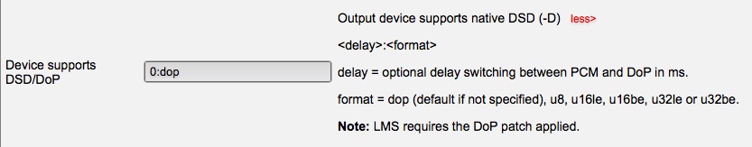

In the attached screenshot you can find how I set the parameter in PiCorePlayer
Yeah found it. And tested it and it works.
My test DAC fooled me into believing that it did DoP, where indeed it is being converted to PCM. With the ā€˜-D’ option this is solved.
I’ll build this option into the beta channel for you to test. I’ll let you know when it lands in beta.
