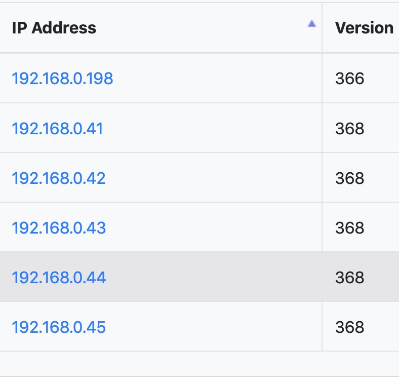

@spockfish Hi Harry…small issue in the sorting…seems its not completely numeric order as .198 is listed before .41
not sure if its XL only as I only use XL now

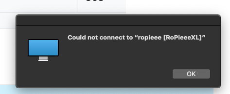

Second issue is when trying to use AirPlay I just get this:
Any ideas? I can stream to the device from the same mac mini using Roon and A+ - just not with AirPlay.

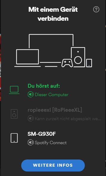

first many thanks for introducing RoPieeeXL. I really wanted to have a Spotify connection. I have changed my Pi3+ to Pi4 now and the installation of XL was very easy. I use the Pi4 with the 7" display and a Lampizator DAC. Now I have 2 problems since I upgraded to XL.
The screen shows the first song I started to play after a reboot but do stick on that when the next song is played. It does not change. When i restart the roon extension it shows the correct song information again for this one song and does not update again.
when I try to connect via Spotify i can see the RoPieeeXL in the device list on every! Spotify App but is is always greyed out and tells me it is not able to play the song on the XL. Of course when I want to play via Spotify I dont play a song in Roon. Maybe Roon does not realease the connection to the XL?

Hi Peter,
For the screen issue I suggest you restart your Roon server and see if that helps.
With spotify: I’ve never seen it like that (the greyed out I mean). Is this also happening when you restart the unit and don’t play anything with Roon but directly with Spotify?
If that’s still the case can you then send me feedback? You can find that option on the ‘advanced’ tab in the web ui.

Hi Harry,
Yes this also happens directly after the reboot. I just sent the feedback: db1939a80a297a12
