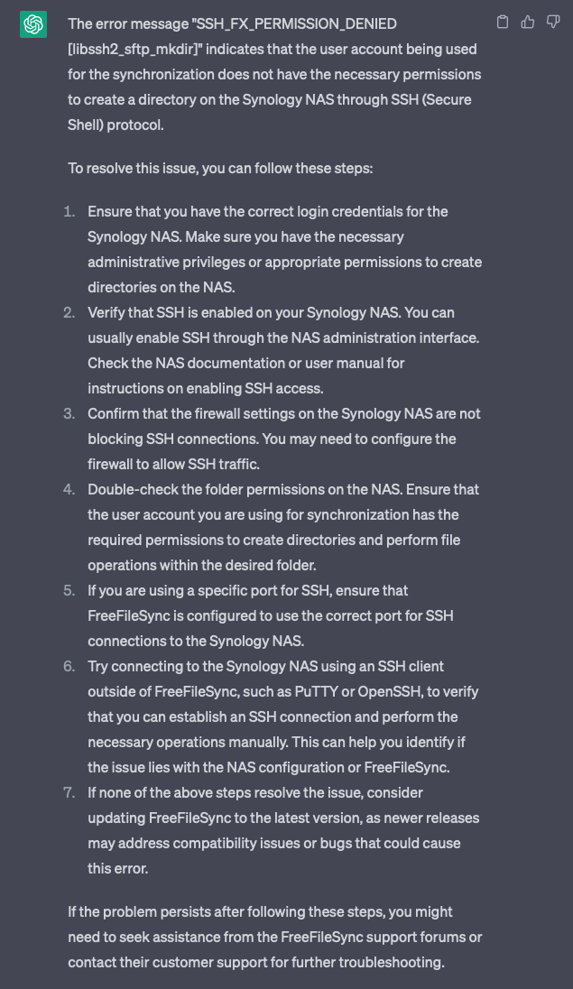

I was just having another go from my windows 11 machine using freefilesync syncing from my NAS folder to the interal SSD both mounted in the Server. I was trying to use the sftp functionality using the credentials I created when I set the server up, but I get this message
SSH_FX_PERMISSION_DENIED [libssh2_sftp_mkdir].
I am not sure why I get this error message, possbily as not logged in specifically using root?

I sincerely recommend opening up a ChatGPT window and using it to consult on everything you do. Be aware that it will make mistakes with confidence. So push back on it if you think itâs wrong
I donât know if I captured your issue correctly but I asked:
Thanks @gTunes. I would not have thought to try that. So I did have a go and after a bit of back and forth, and me asking about root set-up and access âweâ determined root was not set-up. So, I did that and set a passwordâŚit still didnt work. I then went off on my own, and it turns out I need to enable root across SSH, so I did that, and it worked! I could sync my test album succesfully from my NAS to the SSD installed in the Ubuntu Server.
