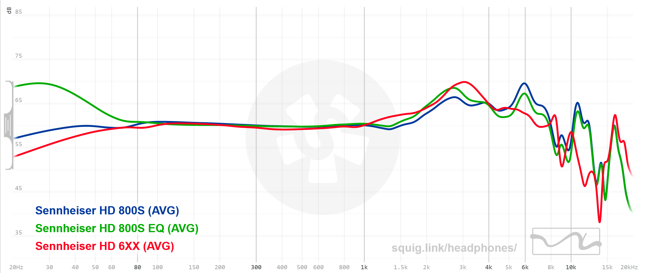

Out of interest I chucked in the ASR values and compared to the 800s and 6XX which are basically a 650 which they compare them to:

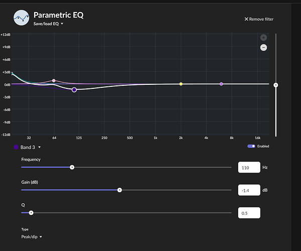

Sorry, I should have been clearer. Those settings you can just pop into Roon. The PK out in front just means set the filter type at the bottom to “peak/dip” (should be the first one on the list). Then it’s just the frequency, the gain and the Q value for each “band” as Roon describes it. This is what the first 3 look like with the entry for number:
