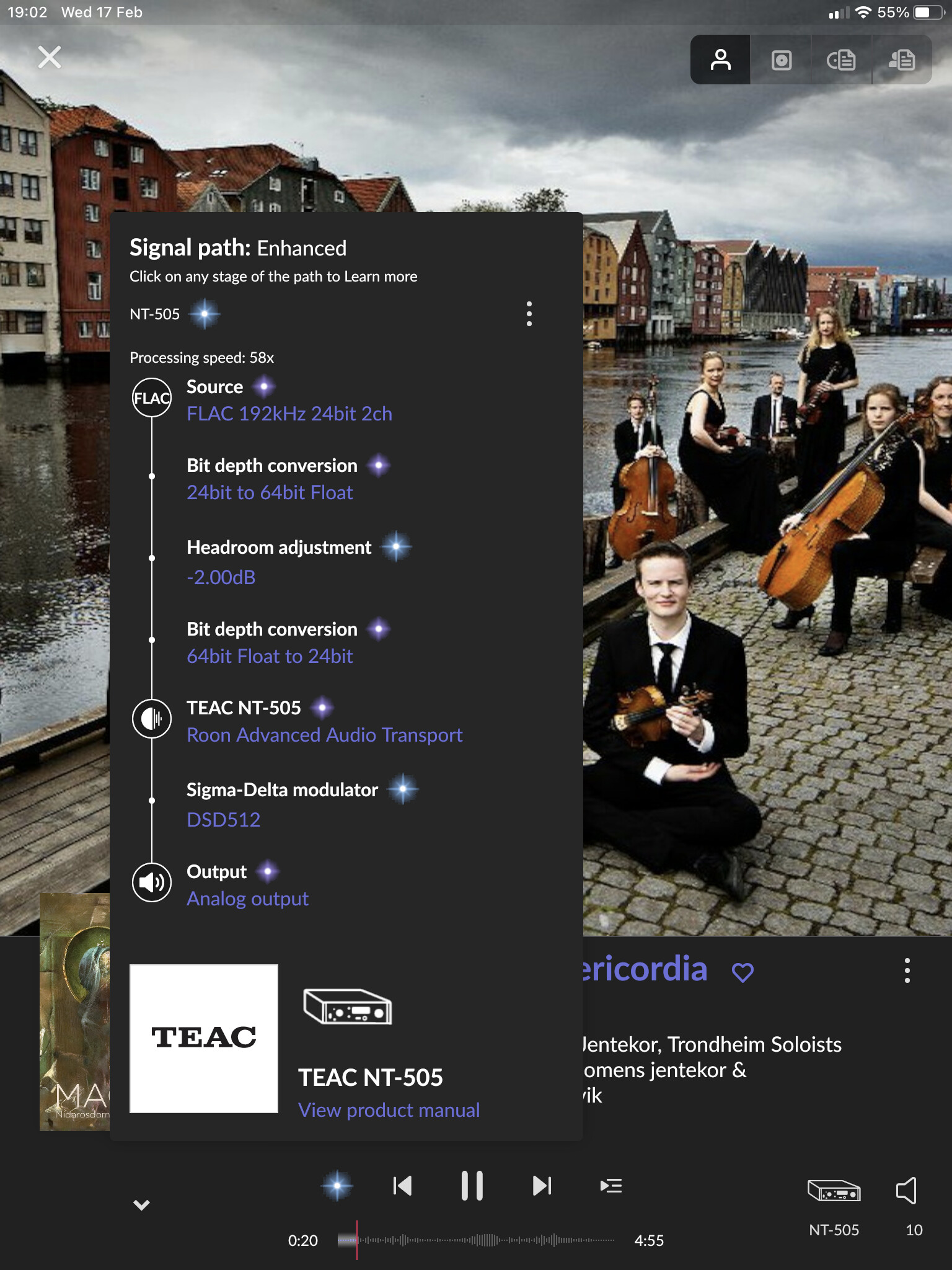

I’ll sort out some screen shots today.
An MQA stream held on my HDD. Local filters are defeated and MQA dictates the DACs actions
The same track, non-MQA. Locally the DAC is set to upsample to DSD.
Finally the same track as a DSD file. The DAC doesn’t alter DSD files.
Hi Henry,
Good to know that NO MQA retains the upsampling function of the DAC.
Renderer only is no option for me because my UD-505 did not receive an MQA ‘upgrade’ through the latest firmware. Tis only works for your NT-505 which has a network interface. The MQA function works through that interface.
Anyway, we now both have our specific best settings.
