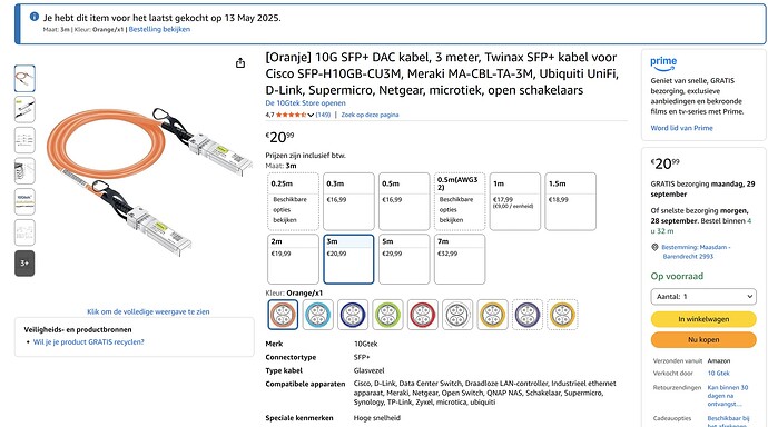

I have a Lumin X1 and for storage a Lumin L2 (8TB) .
The L2 is connected to my switch (SOTM) with a 3 m orange 10G SFP set (Amazon).
The X1 is connected to the L2 with a 50 cm orange 10G SFP set.
No problems with the 10G sets and audio quality not different from my former Finisar coupled X1 only.
Are they 1G modules from 10Gtek brand? Or 10G modules?
More often that not 10G modules usually do not work on Lumin products.
### R H Maasdam r.h.maasdam@gmail.com Bijlagen12:40 (23 minuten geleden)
aan Peter
Hello Peter, your comment is correct. Maybe the solution is the total combination offered by 10Gtek. As far as I can see the cable is 10G. The former connexion to the X1 was the tiny 2 core cable with 2 separate 1,25G Finisar modules. The 10Gtek is a fixed combination of a cable and 2 modules. The SOTM switch has 2 SFP ports for 10G. Hereby a copy of my purchase. I hope that this info is usefull for you.
You’ll appreciate this is not a optical solution as discussed earlier in the posts, right? Cheers.
I have tried quite a few transceiver’s with my X1 in the past, and settled on the Finisar FTLF1324P2BTL as my favorite.
