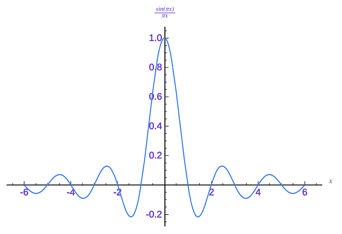

This is a sinc graph:
It is the time domain impulse response of a linear phase brickwall (or similar) digital filter.

To be more exact, that’s the “normalized” sinc function, where the argument is scaled by pi.
According to the sampling theorem, it’s the only filter that exactly reconstructs the analog signal from its digital form, and the only one that resolves the correct missing samples during up-sampling, i.e. the ones you’d get if you sampled the original analog signal at the higher rate in the first place. If you use any other filter, even a minimum phase one, you won’t get back the original, so why would anyone?
