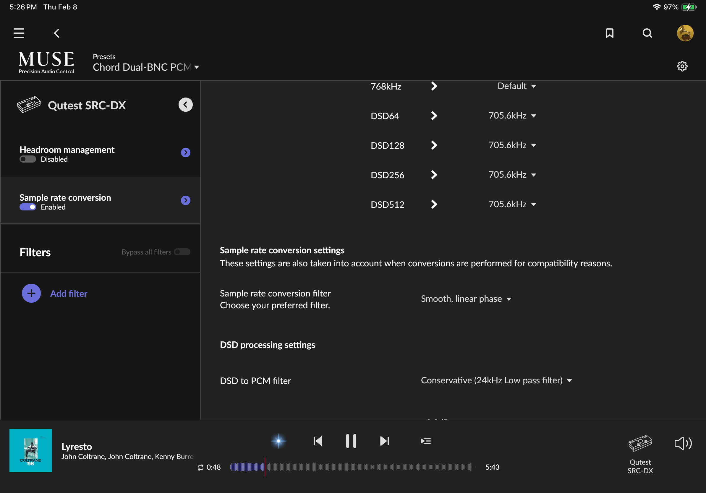

Speaking directly to the ‘Sample Rate Conversion’ function within MUSE, and the ‘Sample Rate Conversion Filter’ drop-down menu within that. Current options are Smooth/Precise combined with Minimum/Linear Phase.

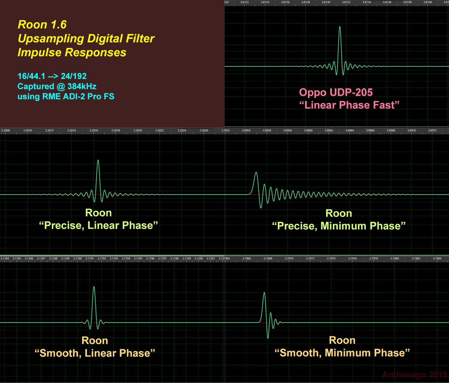

Both linear phase options already are sinc type filters. Of the two, Precise linear phase more closely models a sinc function impulse response.

For reference:
AJ
Thank you. That’s superb info and shows that there is a significant reduction in reserve CPU power moving from Smooth Linear to Precise Linear as I upscale to 705k/768 to send to my SRC-DX. 31x-33x reserve on Smooth/Linear vs 11x-13x on Precise/Linear.
