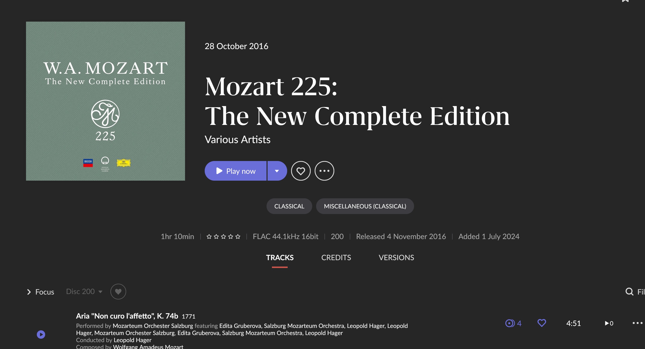

This is a monster set with monster credits , every disc is trying to search the set and load the credits as opposed to loading everything at once .
Roon cannot handle this set it appears except in it’s volume form, there are 4000 tracks involved and however many credits.

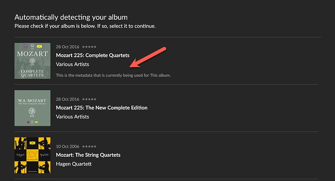

The answer was to “identify” each album again in Roon (Album editor / Album options / Identify album), and change the source that Roon uses to obtain its metadata. Luckily, the Mozart 225 set being a compilation, many albums preexisted and could be used in this way for identification. Moreover, DG/Decca had published some time ago the same content split in smaller collections, for downolad. Separate sets existed for Complete Quartets, Complete Symphonies, Early Operas, Serenades & Divertimenti, and the like, abvailable to be used as source for identification in Roon.

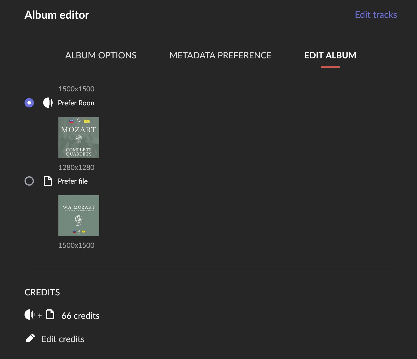

See the image below. A CD of the Mozart 225 set containing Mozart’s string quartets is currently getting its metadata from “Mozart 225: The New Complete Edition” (See the message “This is the metadata that is currently being used for This album”). But when “identifying” it again in Roon, I can switch the source, for example, to “Mozart: the String quartets” by the Hagen, or “Mozart 225: Complete Quartets”, which surely will have fewer credits than the Mozart 225.
And indeed, by selecting “Mozart: 225 Complete Quartets”, the number of credits for this album are reduced from the initial 1215 to a much more manageable 66.
Voilà. All the performance issues are gone for each of the albums in the 225 set that I have modified as described above. Until now, I have identified again with this process about 40 albums. All of them load, play, or open for editing without delay.

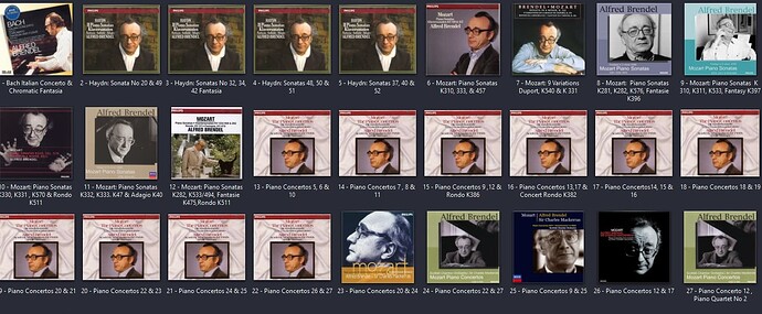

I am hoping for this (taken from my JRiver legacy library) … There are 114 sub discs , arranged like this

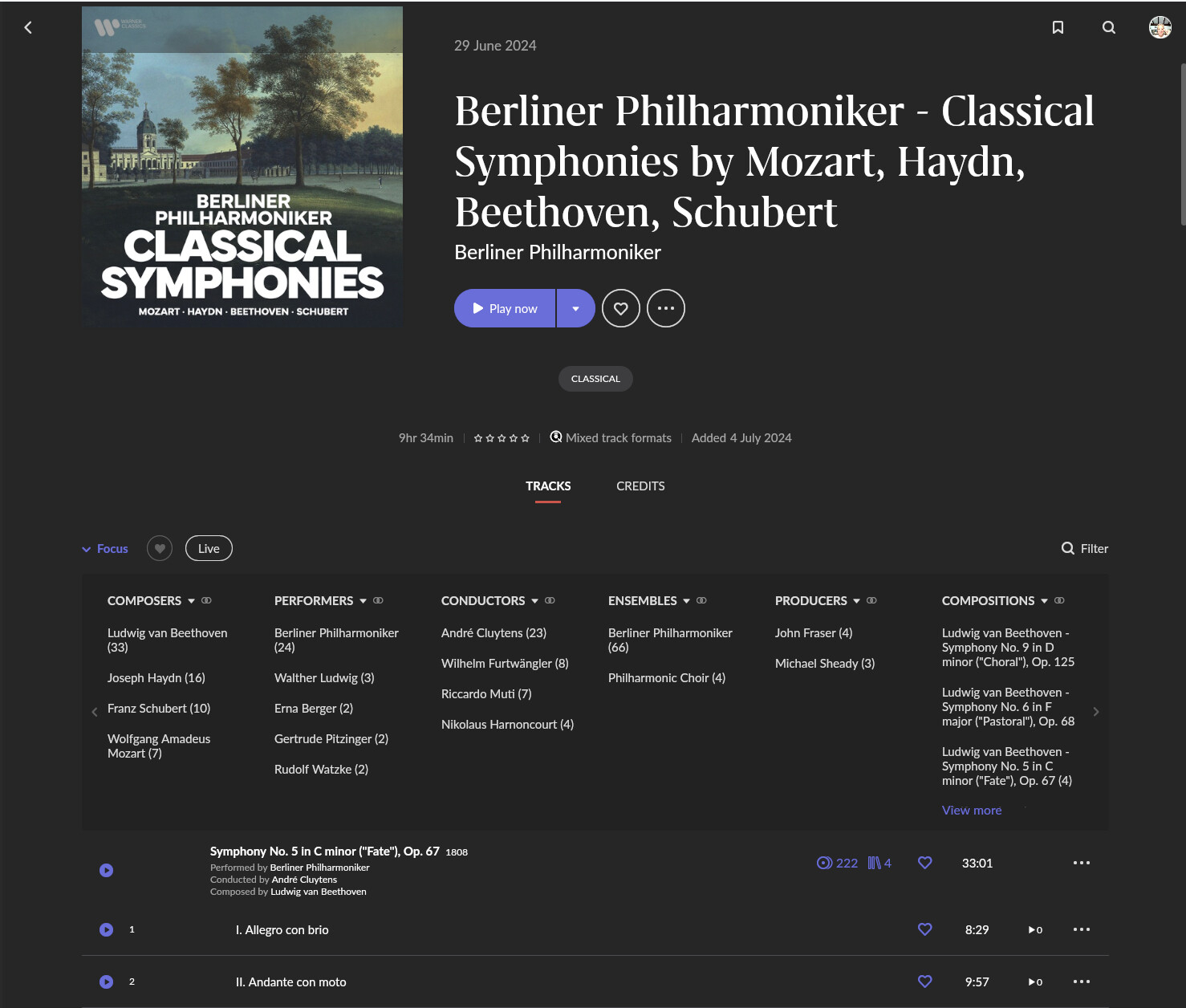

Isn’t that what Focus is used for? E.g.:
Yes Between Focus and Filter I agree you get most of what you want.

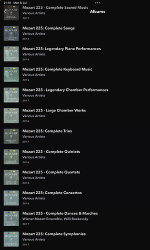

Indeed. I can imagine Music Brainz is just using the split Mozart edition that DG/Decca published for the downloadable version of the Mozart 225 Complete Edition.
Here is most of the Mozart 225 collection as appears in Tidal, for example,
