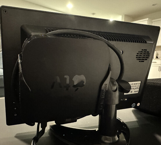

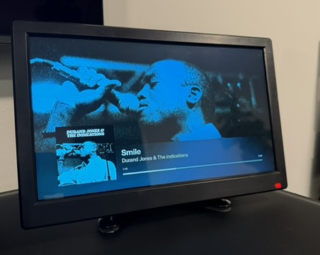

A couple of recent discussions here got me thinking about building a small Roon display based on Apple TV and the Roon TV:Remote app/extension. Wasn’t much effort to put it together.
Here are a few pics of the device including a shot of the rear side:
ADDB9BE9-6408-4693-9AC8-9566B645D8B6_4_5005_c
The monitor is an 11.6" IPS display that runs at 1920x1080 purchased on Amazon. Mine is labeled “Hikity” but there are other similar/identical devices available. Display cost was $76.99USD.
I had an older generation Apple TV I wasn’t using. I mounted it to the back of the display using the adhesive-mount option of this part:
https://www.amazon.com/dp/B017S25FMA?ref=ppx_yo2ov_dt_b_product_details&th=1
I used a .5m HDMI cable that has left and right angle ends.
I like this little device so far. The TV:Remote app is fantastic - supports simple library browsing, transport controls and volume all with the Apple remote.
Because I already had the Apple TV, the parts cost was less than $100. Not bad!
