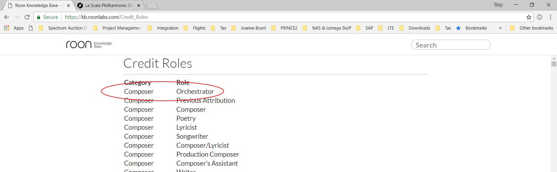

In case anyone else is being puzzled by this, I have just realised that the meta-data suppliers appear not to use the roles “Orchestration” and “Orchestrator” consistently. Roon will map Orchestration as a production credit but it will map Orchestrator as a composer credit. Nine time out of 10 that is probably what you really want:
This is an extremely common problem. Another famous example is Mussorgsky orchestrated by Ravel (Pictures at an exhibition). Core albums of the repertoire like Karajan’s Deutsche Grammophon Bolero give Ravel an “Orchestration” credit for Pictures at an exhibition rather than an “Orchestrator” credit. It means Ravel does not appear as a composer and it messes up quite rudimentary searches returning unexpected results:

Geoff, I don’t suppose you know where the roon “roles” list originated or what the reasoning is for the mappings?
https://kb.roonlabs.com/Credit_Roles
It is pretty obvious that many of the mappings don’t make a lot of sense or are just plain inconsistent. I don’t want my roon cluttered with unnecessary production and performer credits. But I don’t particularly want to delete my “Original Material” and “Cadenza” credits. It is useful informatin. Better would be for roon to map them to Composer rather than Production or Performer.
