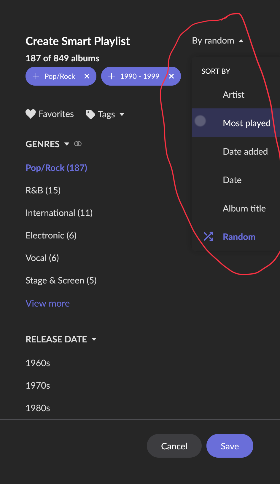

I’m guessing you have the sorting set to “Random”. This can be changed. Unfortunately there is no “random album”, which would randomly play albums in full.
At this time, I think only a sorting on “Most played” (reversed) would introduce some kind of randomness on an album level.
Ah, I see, thank you for clarifying.
OK, so just like with Bookmarks, you can actually get full albums queued from a Smart Playlist. It just won’t be random, since “Random” selection shuffles by tracks and not by full albums.
