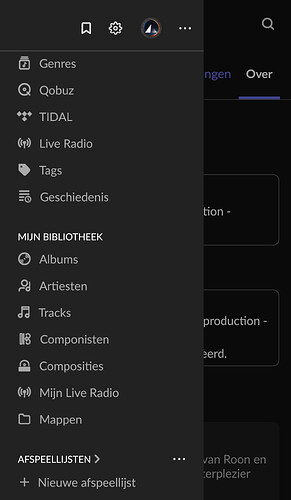

Well, updated to latest built, there is no Smart Playlist option at my end. It just gives me the option for a regular playlist.

…It just gives me…
Others have suggested restarting the Server is necessary. That worked for me…
