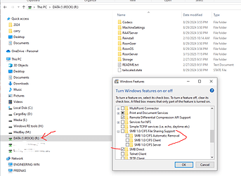

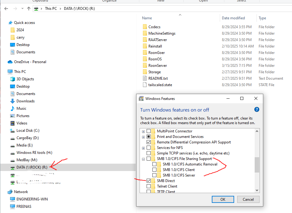

Just as a note to the OP:
I have Rock on Nuc, I do not have SMB 1.0 enabled on my Windows 10 machine and I have no issues accessing the OS drive over the network I have even mapped to drive for easy access.
I do have SMB Direct enabled (SMB 3.x support) whether that makes difference or not I do not know. But maybe that would help you?
I am not an “expert” in SMB protocol so… YMMV and all that.
