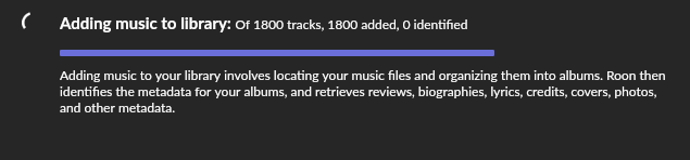

Hi @Ivan. Content is local music. I do this almost every day, so immediately identified the problem related to the newest 1541 build. As you asked, just reinstalled this ea build and added some local files to my current network folder. Went to settings >storage > force rescan. Soon after that the moving circle keeps moving forever but there is no advance adding nor identifying anything:

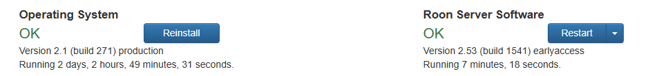

I can restart the ROCK server and will get stuck again (It has three hours now with no advance). Settings >Library will show no activity:

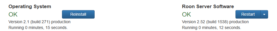

Now it’s time to reinstall with production build; after a couple of minutes I see activity and it is completing the task.

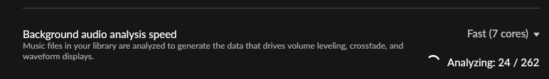

Added 3 new folders. Small (116, 164 and 488 tracks respectively). Activity circle is spinning but no advance. I’m on ea b1541:
![{37567298-8C2A-47C6-A02D-5C9DD862AF25}|690x457]
(upload://ppmO1G8DvT8jnbSOBnxTCctzdVR.png)

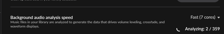

Restarting server as -another- test… After a while, not advancing: Scanned 2 and stopped:

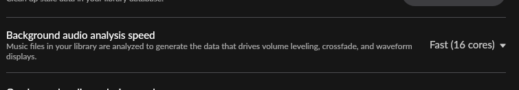

Now it is advancing with the scan, fast:
{B5B51327-E535-4F5D-B5FB-6DD0FE3A626F}
{835619DF-B63D-4D9D-AC8A-B30E6EC53AE5}
{B90AB8C1-1E6D-419B-9251-4EE770912DB6}
{C6BECDC2-10C3-4B7F-8772-FE2CCCC443D4}
Completed the analysis. No more tests for now; sticking with production build until you release a fix…
