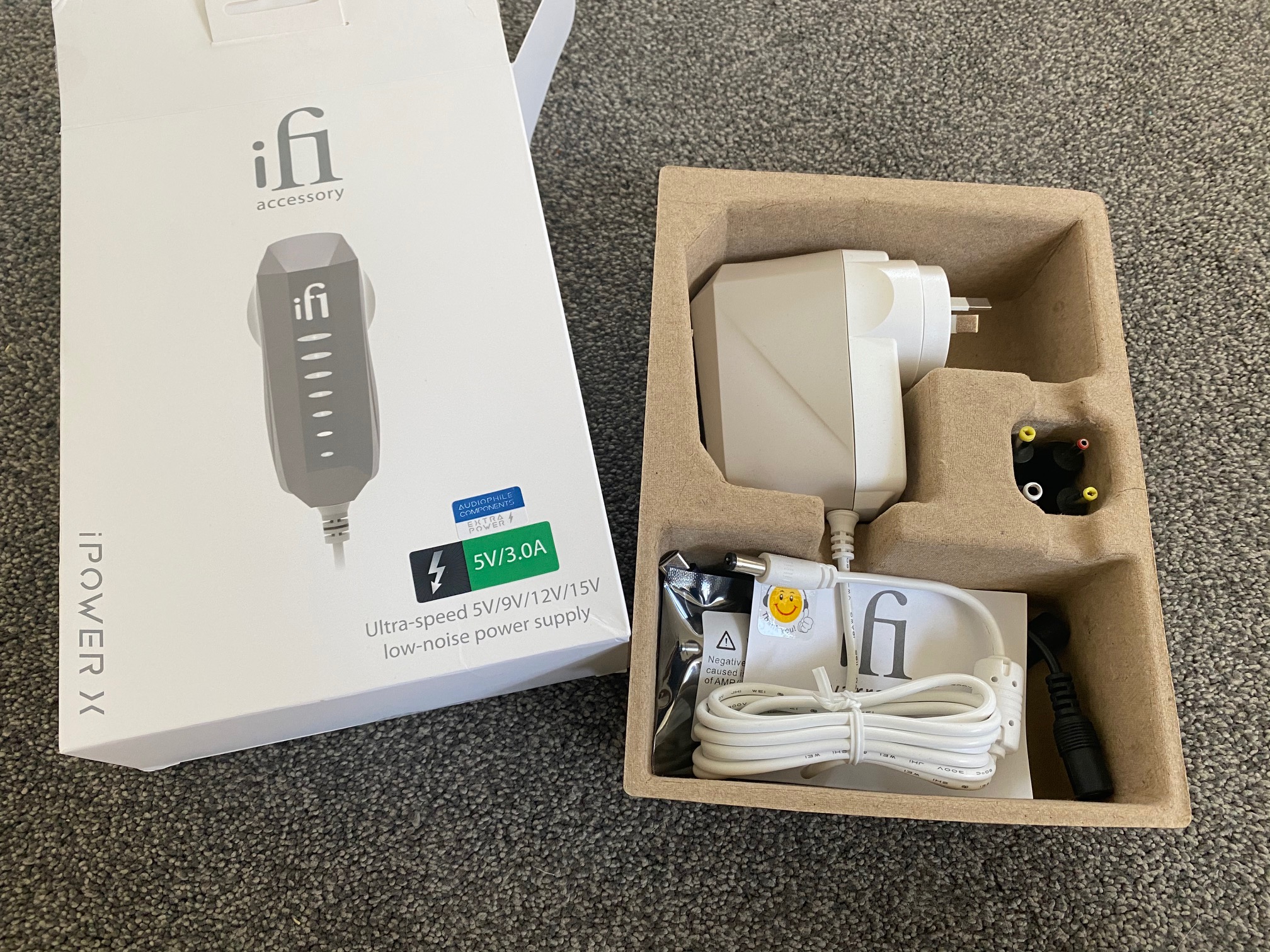

I ended up purchasing the new ifi Power x:
I’ll report back.

Well the ifi power x arrived. Some pictures of what you get:
Need to do some listening…
IMO, the ifi Power X is worth the entry price.
Thanks David for highlighting my incorrect opinions on this device.
It made a very audible improvement to my system, with well known tracks.
