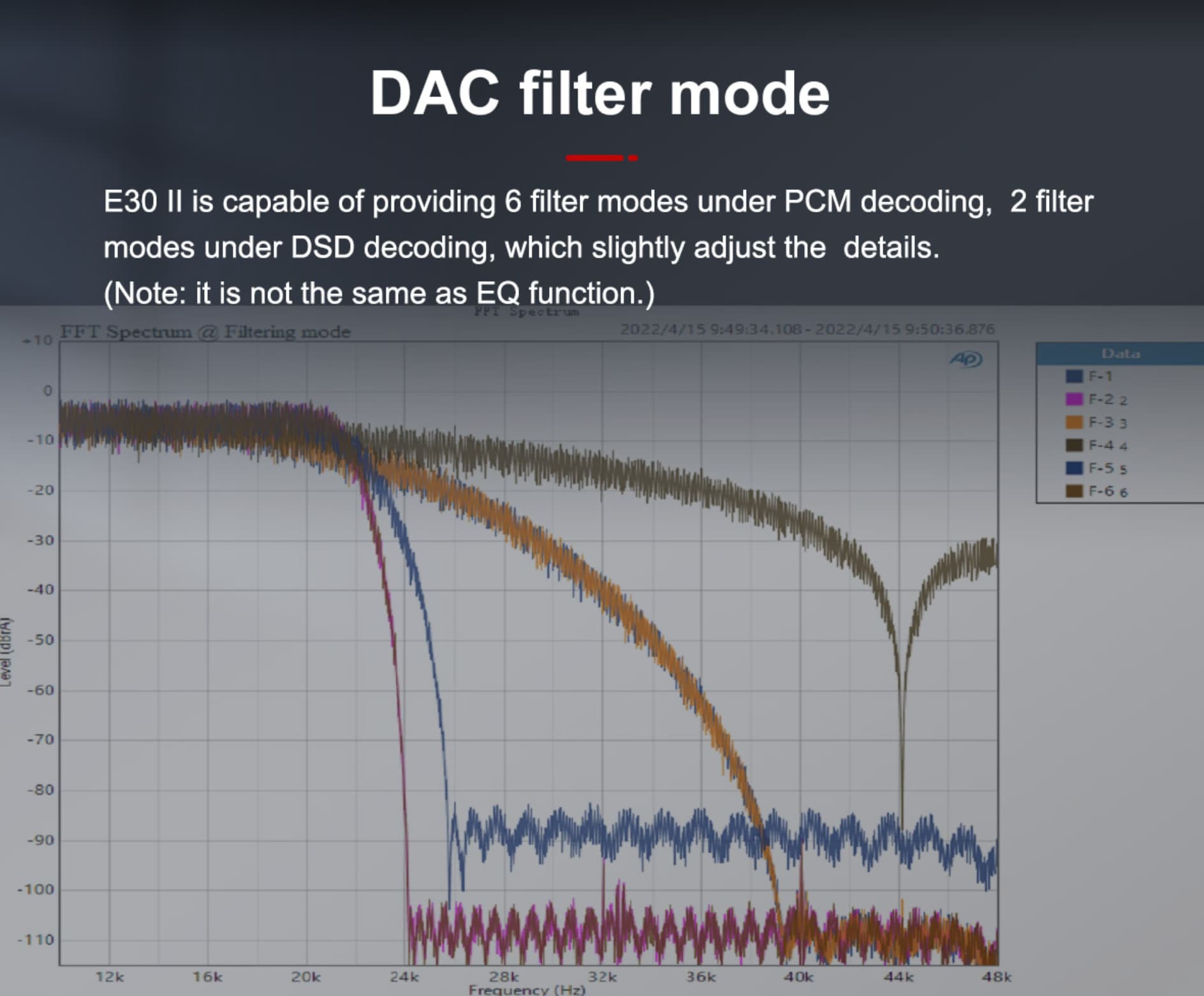

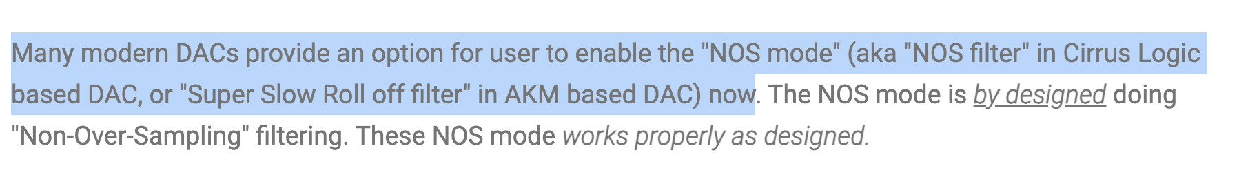

Point 4: “NOS Mode” in modern DACs
The “NOS mode” (aka “NOS filter”) in a modern DAC is, by designed, to faithfully reconstruct audio signal from the digitized input signal. People just “assume” a well-designed DAC should remove the jagged stair step pattern, which is incorrect.
Some people need “NOS mode” feature provided by a modern DAC.
My blog is to highlight that a modern DAC does support NOS mode, by designed, to help to faithfully reconstruct the digitized input in the analog audio signal space.
Point 5: Perfect representation of the original analogue signal
This is exactly the point I want to highlight when I showed the following graph in my blog:
The audio signal re-constructed from a modern DAC for a perfect digitized 10k Hz is not perfect. Do you agree?

In my blog, I want to highlight the following:
Most Modern DACs do support NOS mode by designed. With such mode, people could get stair-step analog audio waveform output. <== factual
Do you agree the above is factual?
(note: “most” here mean DACs based on the latest AKM DAC chips, Cirrus Logic DAC chips)

DACs based on the modern flagship Cirrus Logic CS43131 or CS43198 chips do support “NOS mode” (aka NOS filtering) (as it is part of the chip’s feature).
