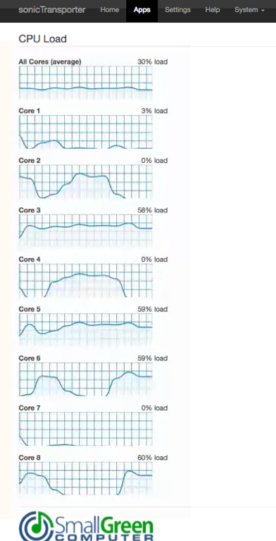

Can you look at he CPU load when this is running and tell me what it is?
-Andrew
Yup, can do later today.
I’ll Team View and bring up sonicOrbiter OS and compare CPU load of ASDM7 vs 512+fs modulators and take some screenshots.
Below is with the ASDM7 modulator. Average is around 32% (eye balling the average over ~ 1minute)
Below is with the 512+fs modulator. Average is around 38% (again just eye balling it).

@agillis what are your thoughts of the above screenshots, regarding the 512+fs modulator? Is something being looked at to further reduce CPU usage overall or not much more can be done there?
