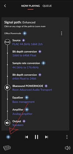

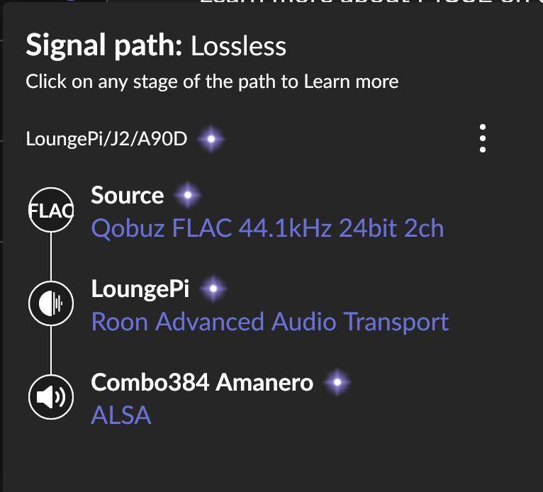

How do I screenshot my signal path? Device setup - it’s just an Ethernet cable into the Pi, then a USB to either the Geshelli J2 DAC, or the K9 pro. No Muse/DSP.
The signal path within roon that is shown by clicking the star as below
Optical is known to have not good jitter, but SPDIF via COAX 75 Ohm cable is rather good!
Read Roon’s help center article here, please, and then provide respective screen shots from your Mac.
There you go, pretty straightforward signal paths I guess.
