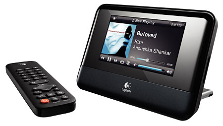

check the thread i posted from the slimdevices forums for instructions on installing, and configuring EDO. from there one simply enables squeezebox support in roon, and points the Touch to roon as the squeeze server. the Darko article provides good instructions. it’s all pretty straightforward, but make sure LMS is turned off if you have it running somewhere on your network.
once setup it works seamlessly with roon.
one small note: it’s best to use ethernet if possible. the Touch has an older implementation of WiFi, and in my experience, it has trouble with newer mesh networks.
Excellent advice and pretty much essential for streaming high resolution audio files to the Touch.
Here’s a simple step by step guide for installing the EDO (Enhanced Digital Output) on a Squeezebox Touch
  1. Make sure the Touch is connected to your network
  2. click on “Settings” on the main menu of the Touch
  3. click on “Advanced” on the “Settings” menu
  4. click on “Applet Installer” on the “Advanced Settings” menu
  5. click on “allow third party apps” (the Touch may reboot)
  6. click on “Enhanced Digital Output” on the list of applets
  7. click on install. The Touch will then install the EDO app and may need to reboot several times.
  8. Once the EDO app is installed go to the “Settings” → “Advanced” menu and click on “Digital Output”
  9. click on “Select Audio Output” and select “Digital Only”. The Touch may reboot again.
  10. Connect the Touch to your DAC using any of the three digital outputs (coax, optical or USB).
  11. In Roon under “Settings” → “Audio” → “Device Setup” → “Advanced” make sure that the “Max sample rate (PCM)” is set to match the maximum sample rate of the DAC’s digital input.
Enjoy!

For some reason the steps above to install EDO were not working for me. I ended up unplugging the Touch then plugging it back in to reboot it. After doing that I was able to get to the step to install EDO and it presented a message indicating that the analog outputs would be disabled. At least for now, I’m not using the digital outputs so I didn’t load EDO.
Also, I noticed my Touch is acting strangely (I haven’t used it in awhile). The Touch is telling me it can’t connect to my Salkstream III streamer (where Roonserver and my music files live), but Roon sees the Touch as an endpoint and will play through it although the Touch display gives no indication of this; no album art, just whatever screen it happens to be on. It use to display the album art.
Right now I’m having the Touch reload the firmware to see if that fixes it. BTW, I’m not running LMS, only the Touch. Could this be an issue? It seemed to work fine before without running LMS.
This whole adventure came up because I’m looking at upgrading my headphone setup. Currently, I just use my NAD Viso HP 50 headphones (with a convolution filter) plugged into my iPad or iPhone headphone jack. I’m looking at upgrading to a pair of Dan Clark Audio Aeon RT Closed headphones and a separate headphone amp, which I plan to feed with my Touch (as a Roon endpoint).
Update: reloading the Touch firmware seems to have restored normal behavior. :+1:

Ugh, today my Touch stopped automatically displaying the “Now Playing” screen when playing to it via Roon (I can manually select “Now Playing” on theTouch). And the clock stopped displaying when off (it does that sometimes for no apparent reason).
Also, I found in the Roon KB that the Touch must be running firmware 7.8.x to use EDO with Roon. My Touch was on 7.7.x with a message “no updates available”. Out of curiosity, I launched LMS on my laptop, then checked the Touch again. This time it showed an update available from my laptop, v7.8.0 (but LMS on the laptop reports it’s on 7.9.0?), so I updated the Touch to that so I can use EDO in the future if I like.
Ugh, all this computer/software mess drives me nuts. :face_with_symbols_over_mouth:
Update: After unplugging the Touch for a bit to reboot, it’s now automatically displaying Now Playing and the clock when off. Go figure. :person_facepalming:
