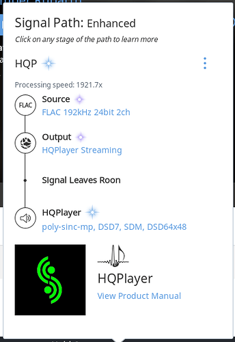

Hey @Go_Ga – I just tried to match your setup and I’m not having the same issue. My Signal Path looks like this:
Are you seeing the same thing? Just want to make sure we’re running the same test before we move forward.
Looking forward to getting this resolved for you soon – thanks!
