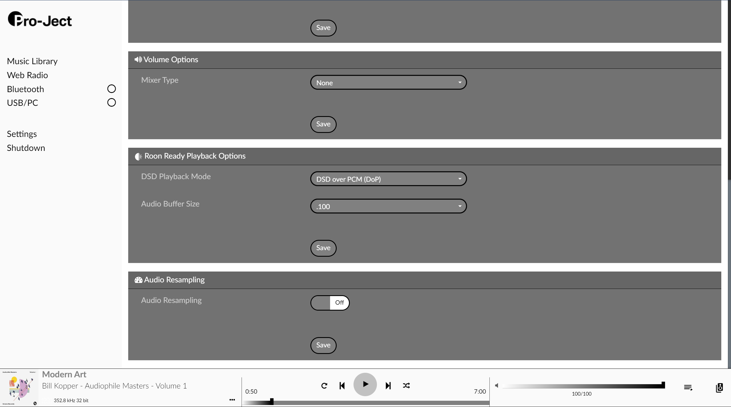

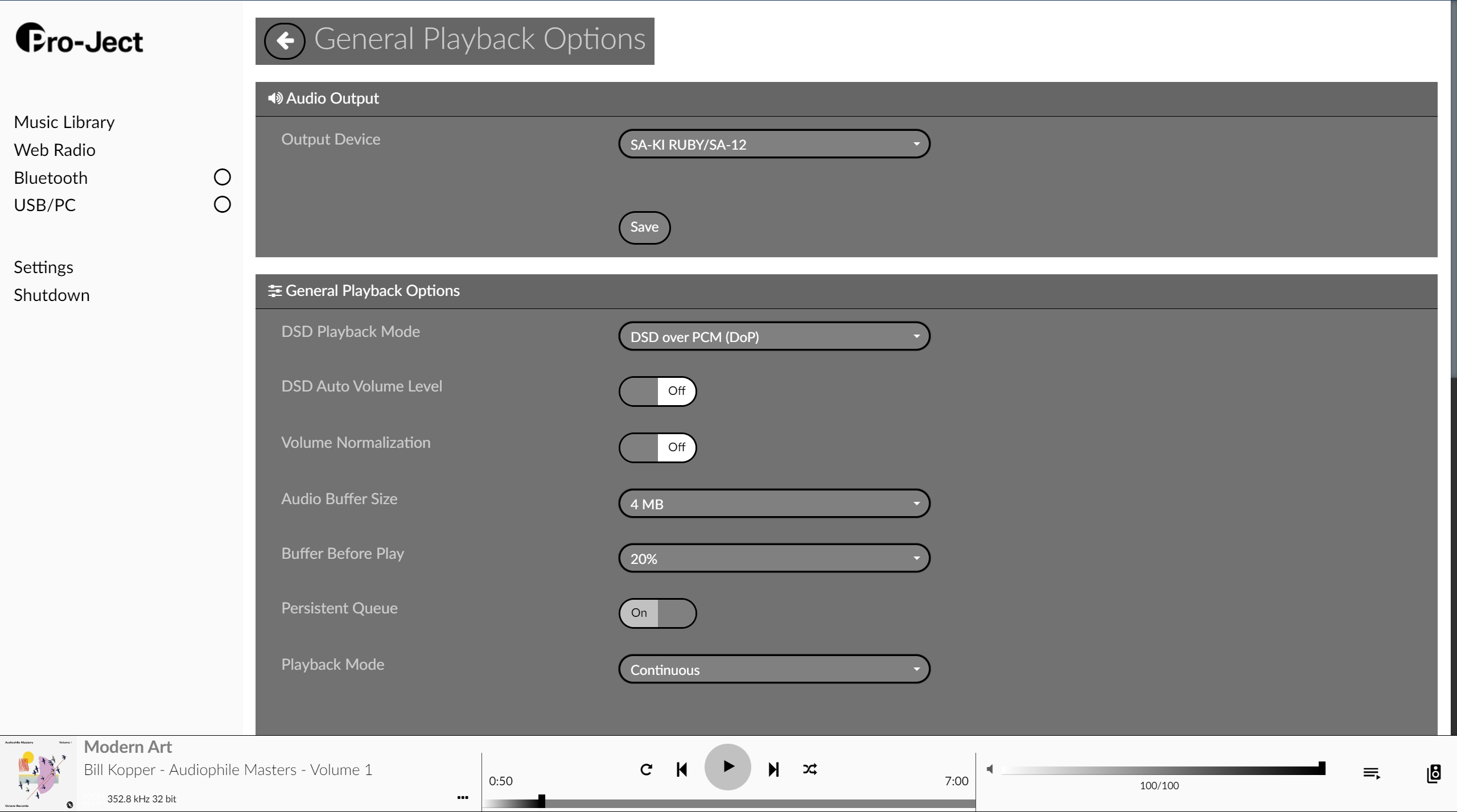

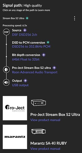

I’ll attach screen captures of my playback settings in the Stream Box S2 Ultra, but I have the mixer type set to None (although it sometimes reverts back to Hardware for some reason). When I configure it to use DSD Direct, DSD music gets converted to PCM and sent to the DAC (more on the DAC later). When I set it to DoP, it works, but my DSD256 albums get downsampled to DSD128. Not the end of the world, but odd, given that both DACs I’ve tried this with support DSD256, and I did not have this issue with my iFi NEO Stream and this same DAC. Most of my native DSD albums are in DSD256–that’s my preference for native DSD albums.

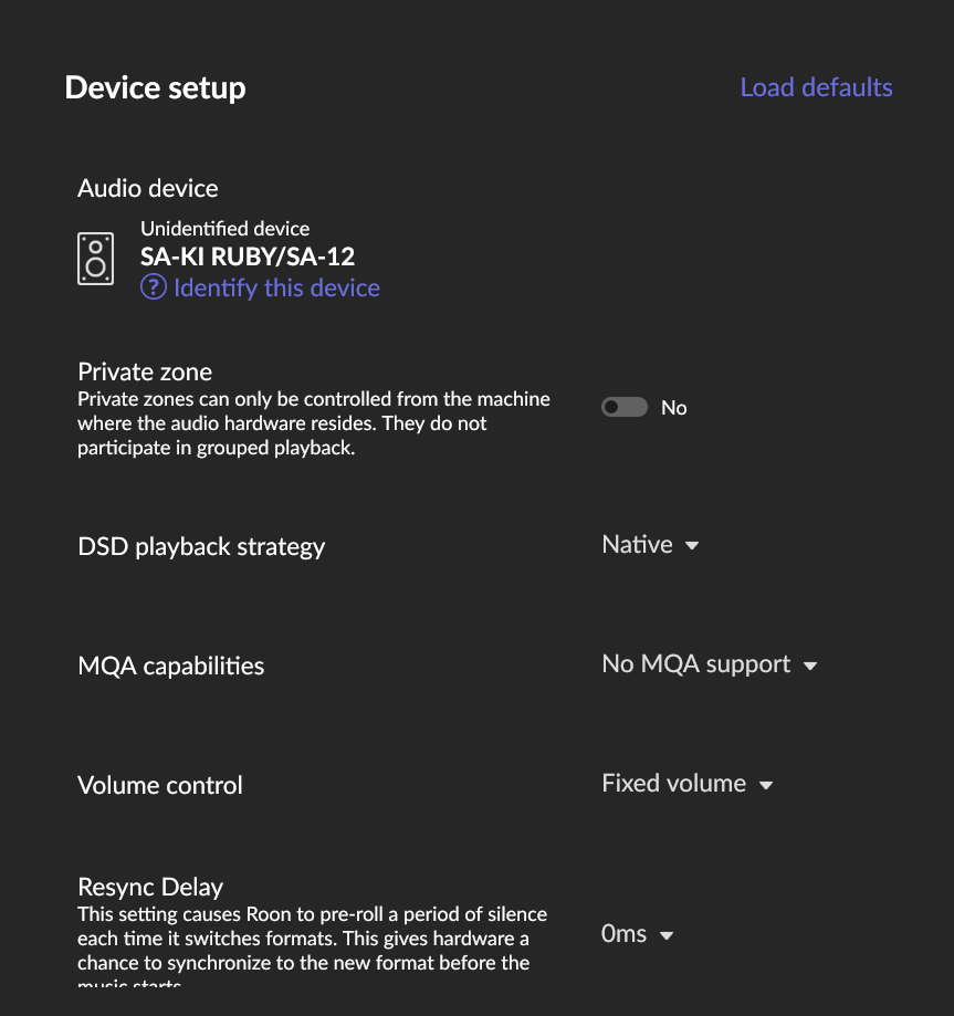

I’ve tested this with two different DACs. The main setup that I’ve used for two other streamers is the DAC in my Marantz SA-KI Ruby SACD player (via the only, USB, output on the Stream Box S2 Ultra). That DAC is recognized by Roon, but for some reason it only lists support for DSD64 and DSD128 in Roon, even though all the documentation I’ve found for this SACD player’s DAC says that it supports DSD256 (and again, this downsampling didn’t happeen with my iFi NEO Stream, which has other issues).

So something seems to be broken in either the Stream Box S2 Ultra’s handling of DSD, or in Roon’s implementation of it. I would greatly prefer to be able to use DSD Direct, but DoP isn’t a deal-breaker to me. I am bothered by the downsampling of my DSD256 albums. This is my fourth attempt to try to find a streamer that will properly and without annoying bugs (as I have with the iFi NEO Stream) support native DSD playback via Roon.

It’s because the dac can’t handle higher pcm to encapsulate DSD256 it needs 512/24 to be able to handle it over DoP.
As for the Kai Ruby it needs to use USB A Input for the higher DSD256 but that’s native DSD not DoP, it only supports DSD128 for DoP as it’s limited to 384/24 pcm.
Thanks for the reply. So it sounds like I may just have to live with this. Everything I’ve heard from reputable sources indicates that DoP shouldn’t cause a hit to sound quality, but it would be nice if I could get DSD256 support. I see in Roon that from my laptop to the Chord Qutest DAC, it has to use DoP, but it doesn’t downsample DSD256, so I think this is specific to the Pro-Ject. I’ve heard that DoP has to be used when sending DSD over USB, at least when Windows, MacOS, or Linux is involved (my laptop is Windows 11).
